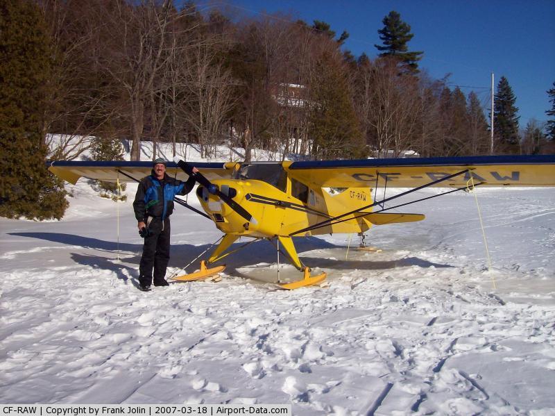

      This pix of a Taylorcraft belonging to a Canadian flyer shows the "inside of the grills" covered with duct tape, as is the opening located below the prop. I've done it this way without any problem. I usually just cover the hole below the prop with an aluminum plate and install the Univair cold wx wraps over the oil sump and the 4 induction tubes. I haven't found it necessary to use the tape over the inner grill portions unless it's -minus 20 or so. When I first used the tape on the grills, I used one width of duct tape over the inner portion of each grill...flew around and watched the oil temps...landed and added another piece(overlapping the outer edge of the previously-installed piece(s)...flew around some more and added another piece(basically blocking the direct air flow over the barrel of of each front cylinder, but not much of the finned area).
      The duct tape will stick quite well to a warm cowling...or you can use a hairdryer to warm things. If you leave the tape on into the spring/summer...it will probably be hard to get off without some "Goof-Off" adhesive remover...(or it may peel some paint!) If I were experimenting with this idea...I would probably use some flat plastic pieces cut from a milkjug or antifreeze jug...drill some properly-spaced holes and fasten the "blockoff" over the selected location on the inner grill, using a good grade of Tywrap(you could use stainless safety wire, but don't booger-up those hard-to-find grill pieces) to attach each piece so as to prevent any movement. (I've seen metal covers made with bolted, adjustable slide pieces that allow you to change the amount of air passing through.) The "plastic/tywrap" method allows a quick experiment without much hassle and will give you an idea of what occurs when you restrict some of the cooling air. Remember, it may be very cold on the ground and the engine may "like" the reduced cooling...but if you climb up into an inversion where it is considerably warmer...you may need more cooling. Keep a close eye on your oil temp. Here in Alaska, where ski operation is very common...we have a lot of places to land and it's easy to set down and adjust the modified cooling setup. Use your good sense and your mechanic's oversight. Also remember that partially blocking the ram air to your heatmuff may effect carb heat and cabin heat. Dick

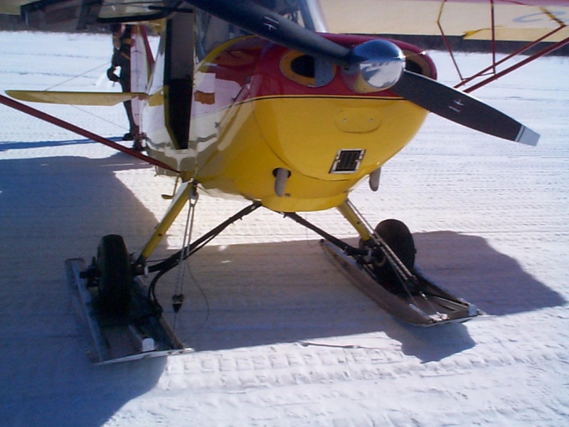

      (The picture of the Aeronca shows a similar setup to reduce air flow)
