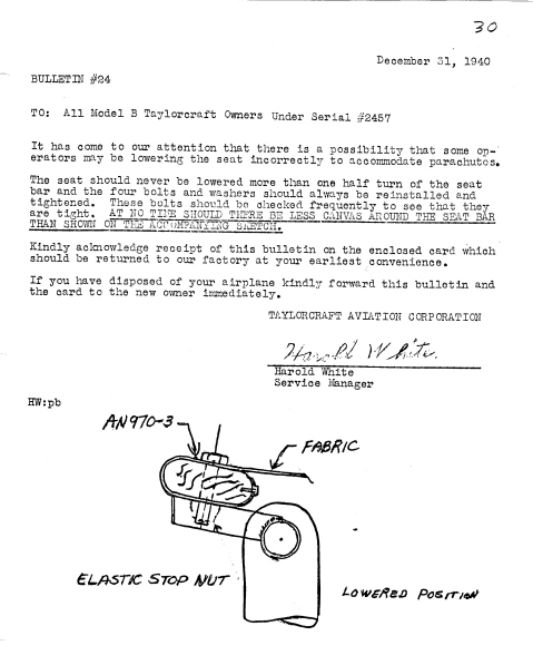

    Here's a Service Bulletin on wrapping the front edge of the seat sling around the wooden slat.
    The end with the grommet holes should go up to the cross tube that would be behind your shoulder blades and be laced around the tube only. The center fold line with the other parallel rows of grommets would lace around the lower cross tube where the seat bottom meets the seat back (do the center one first, ask me how I know). The end without grommets should be screwed in along the thin edge of the lath then rolled around the lath and bolted with four A.N. bolts to the fittings welded to the lower front cross tube, per the attached S.B. you've probably already found the tabs welded there for your kick plate to screw into also... h

      Thanks Howard, that's quite helpful. It confirms that we did the right thing taking the wood piece off the front of the baggage area, and gives a clue on how to set up the front bar that you wrap the sling around.
