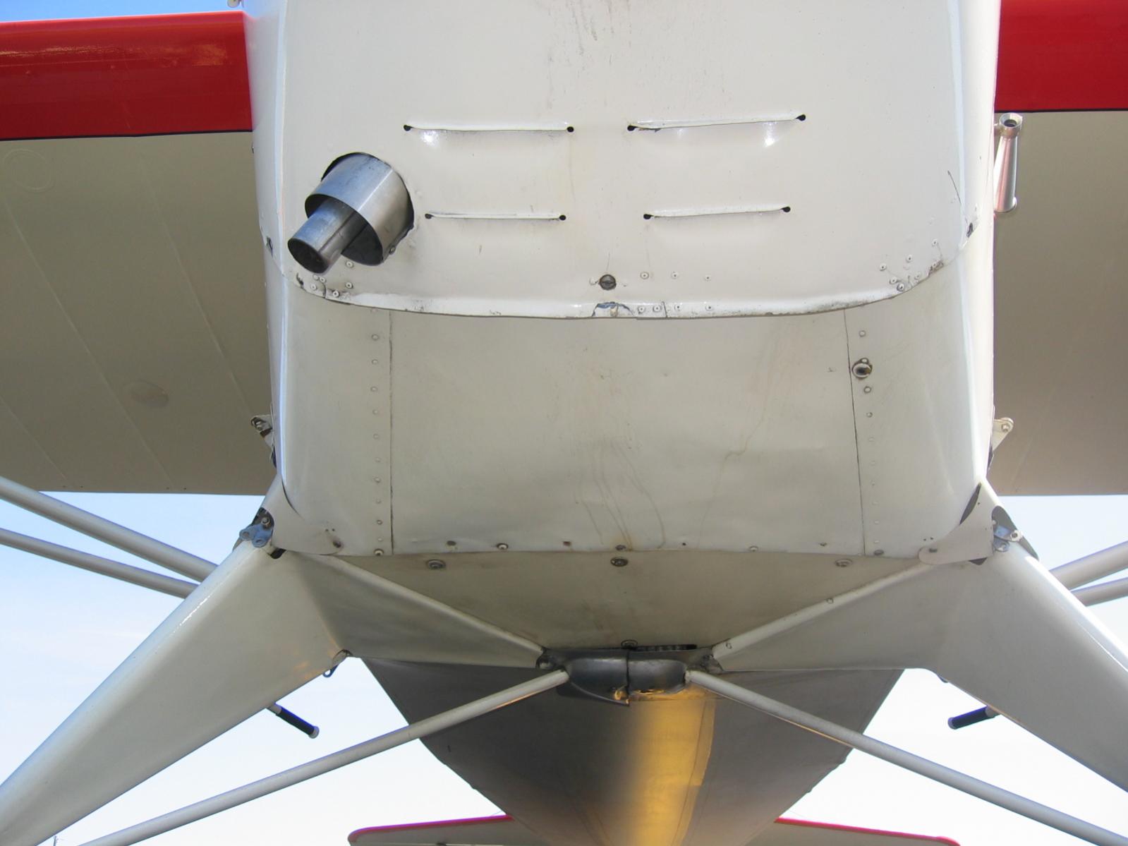

                    Thanks for the suggestions! Here’s an update on where I’m at with this. To definitely confirm there was CO present in the cockpit, I took a battery operated detector from home—great idea by the way—with me on a flight. The peak reading from start up to shut down was about 109 ppm. This occurred prior to take off. During flight the readings were around 50 ppm. This was with the windows partially open, all openings through the firewall well sealed and outlet of the cabin heat taped over.
                    I hooked up exhaust end of a vacuum to the exhaust pipe and used soap solution to look for leaks. There was one small leak in a weld at the point where the two sides join into one, a problem but not big enough to be the primary source. The major leaks I discovered were at the junction of the exhaust pipe with the two back cylinders.
                    At this point my theory is that the escaped exhaust is exiting at the bottom rear of the cowling where it flows adjacent to the fuselage and a portion is coming into the cockpit via the bungee covers and seams along the landing gear. I have some ideas on how to seal this area but eliminating leaks in the exhaust is the priority.
                    The local advice I’ve received so far is that the existing exhaust pipe cannot likely be repaired to address the leak at the cylinder heads. I have looked a bit to get an idea what the cost of replacement will involve and am planning to do more research on the forums to see if this has been addressed in the past.

                              The exhaust gasses tend to follow the bottom skin of the fuselage to the tail area, where there is a low pressure area inside the fuselage. Any openings along the bottom skin aft of the cabin will pull air in from the outside "boundry layer". If the exhaust gasses are there, in they come. Two ways to address the problem: Close the holes; or extend the tailpipes a couple of inches away from the skin.
