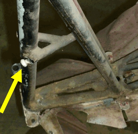

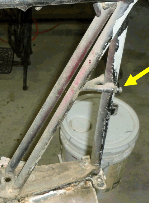

      Here's what mine ('46 BC-12D) look like:
      I pulled 10-32 x .75" long round-head machine screws out of the two holes.
