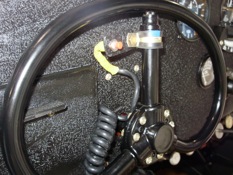

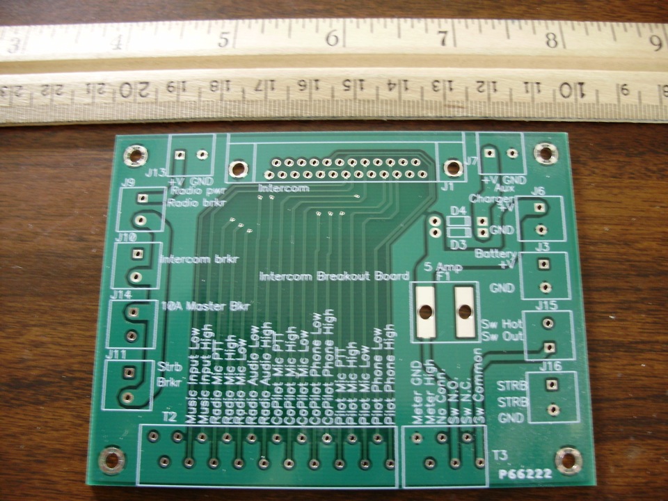

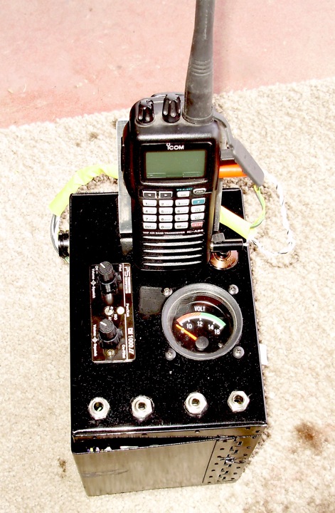

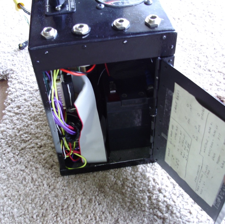

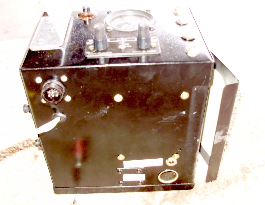

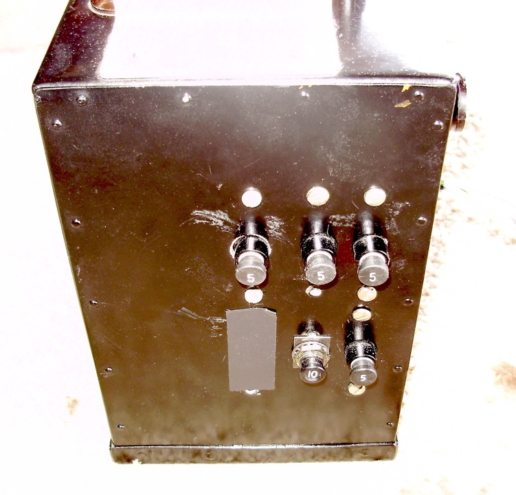

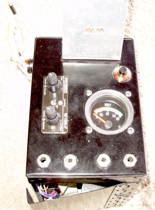

    Here are some photos of the radio-intercom package we made for Doc. Start with the bare circuit board, wire it, mount it in a home-brew black box, and outfit the box with volt meter, aux power output, radio mount, input /output wires, circuit breakers, and a charging jack.

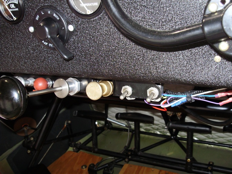

    The large black umbilical has 6 wires. Namely, Master switch (2 wires) Strobe power (2 wires) and Push to Talk (2 wires). This large wire bundle is wrapped in "snake skin" and routed to the instrument panel via underneath the floorboards and up the side of the boot cowl. The Master Switch on the panel (Left toggle switch, not yet labeled) switches on the 12V 7AH gel cell mounted in the black box. The right switch on the panel operates a strobe light on the rudder. [We discovered a noise issue when running the strobe, so will have to shield this circuit somehow.]
    Pilot and copilot PTT are routed to the yokes - see picture. The PTTs are grounded back to the box through the strobe ground wire - {maybe a source of noise?}

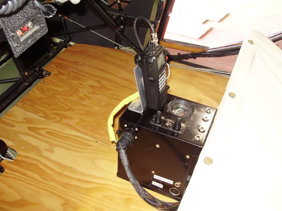

    The box will be braced at the floor using angle brackets screwed to the wood and with a bungee cord holding it back to the kick plate.
    Next post shows the installation.
    Re: Intercom and Radio Package
    Here is the panel, yoke, and installed package.

          Where did the printed circuit board come from? Nice installation and if you went with LEDS for the nav. lights you would have a complete system.

            The circuit board was developed by my oldest son (computer engineer in Maricopa Arizona) because he has a fab house that he does a lot of business with and he has the layout software. The silk screen still exists and more boards can be fabricated very easily. I would have to find out the cost but it will be cheaper for follow-on orders than the initial set up fee which was $125.

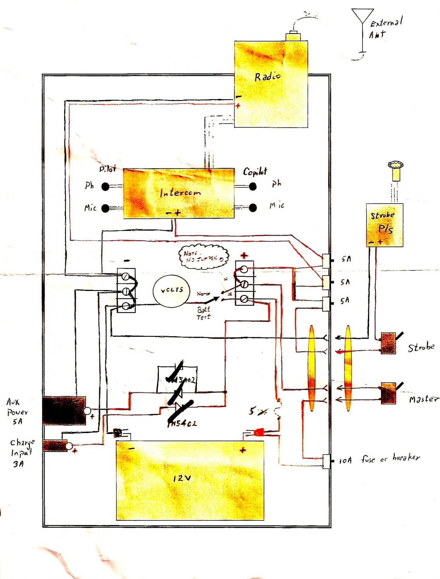

            Design Parameters as Follows:
            Built around the PS Engineering 1000 II intercom. Chosen for having dual squelches since none of my headsets match one another.
            Handheld radio interface - because I had a handheld already and could not afford a Microair as per DJ's more elegant radio box.
            Huge voltmeter - for weak eyes.
            Aux Power output for my GPS.
            Strobe output - for tail mounted Whelan strobe. unfortunately very noisy so I need to troubleshoot and shield this circuit
            Circuit breakers - because I had a pile of them laying around and they are common as dirt in aircraft salvage.
            Remote switches - because they are cool. They could have easily been mounted on the box itself.
            Test button - to see battery voltage when the box is not with the plane. Would not be needed if master was not remotely mounted.
            Remote PTTs - also cool, and could have been put on the box vs the yoke. These are a must have item and are not shown on my block diagram - but extremely simple to wire.
            Block diagram is attached. The only modification I made was to eliminate the diodes. They really did not help.
