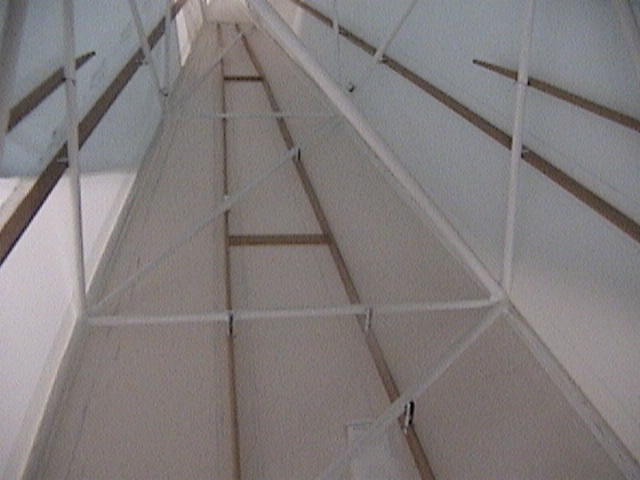

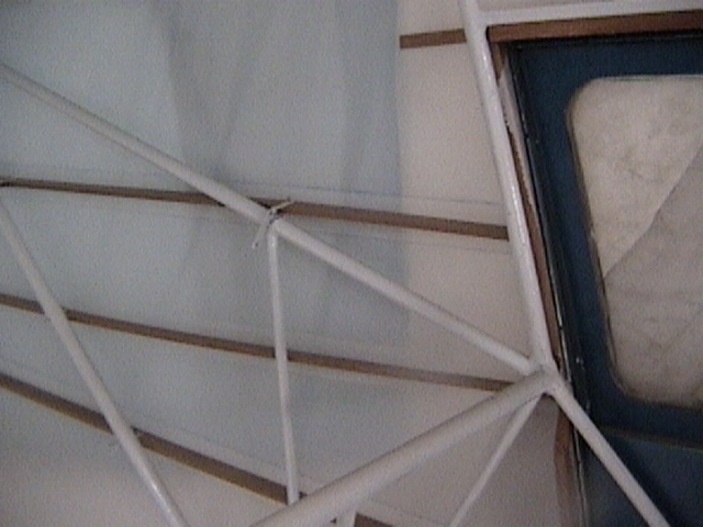

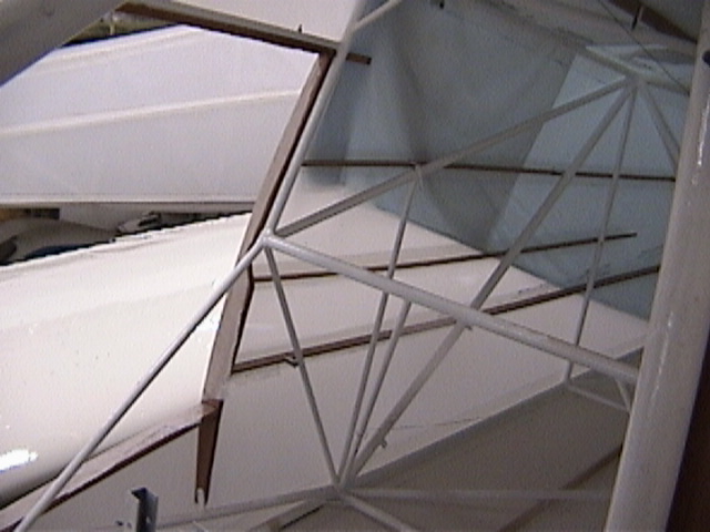

      Here are some pics of the inside of a BC12D that was being restored at a nearby repair station.
      The drawings I have for the Harer STC show only ONE stringer about halfway up the side that only goes about half the length of the aircraft.

        Re: metal Stringer madness
        Thanks for the pictures. As far as I can see the wood configuration is exactly how mine were set up. I just wonder whay Taylorcraft went to a different configuration with the metal ones? The wood ones were cut to fit smoothly over the tubes. The metal used wood blocks and springs to hold them in place. If I did go with the one long and two short on the side I just wanted to see if there was a standard configuration. The Harer STC does indeed only show one on the side but I have never seen a Tcaft with just one.

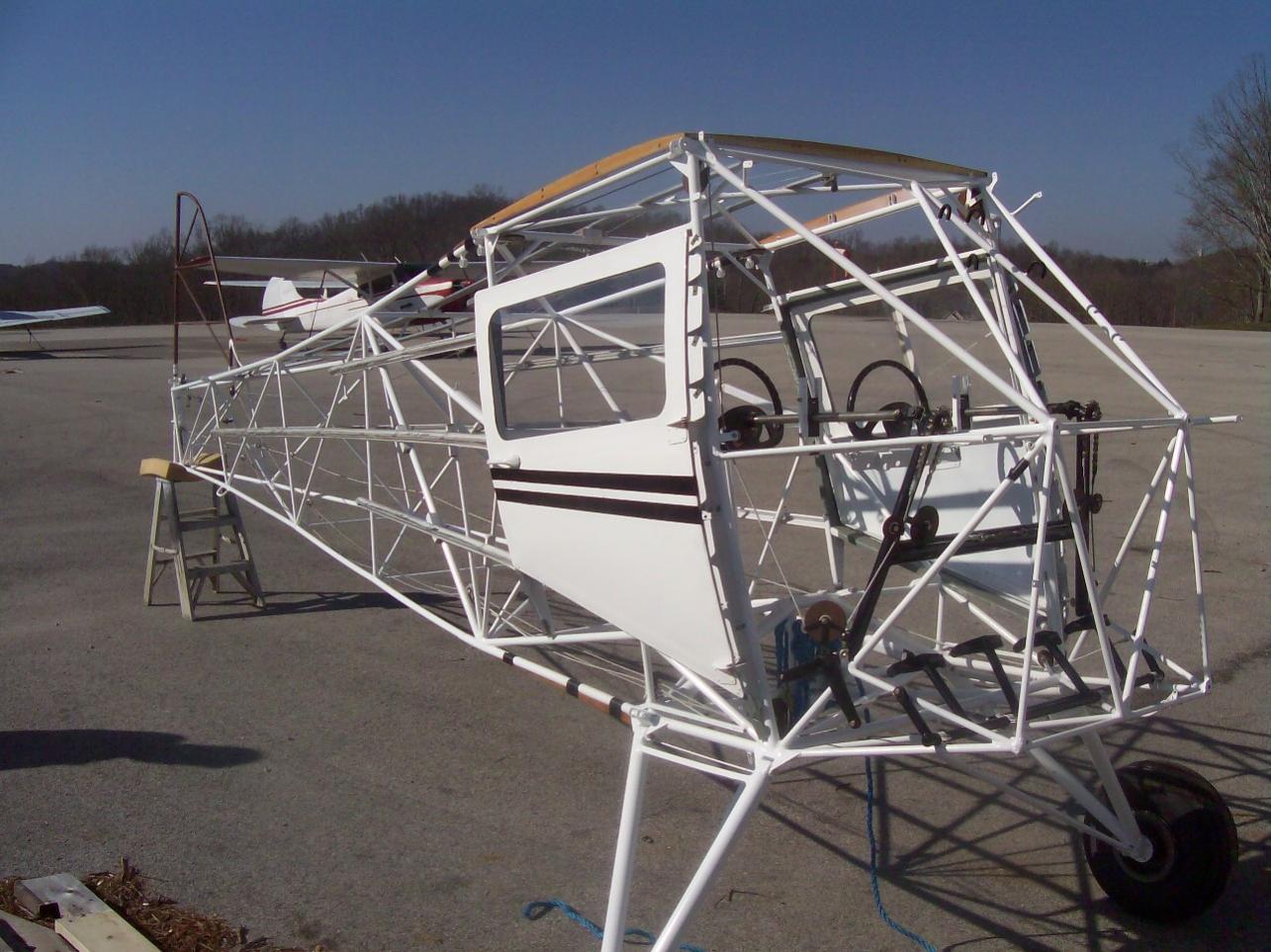

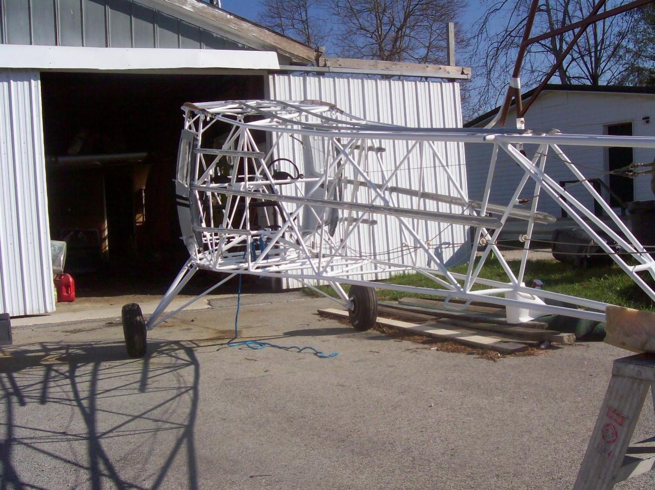

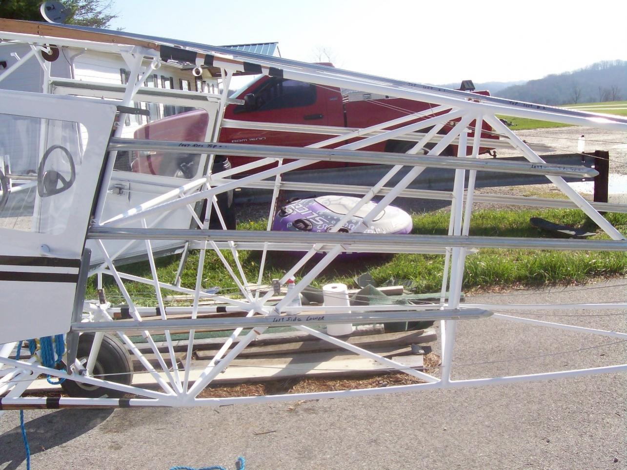

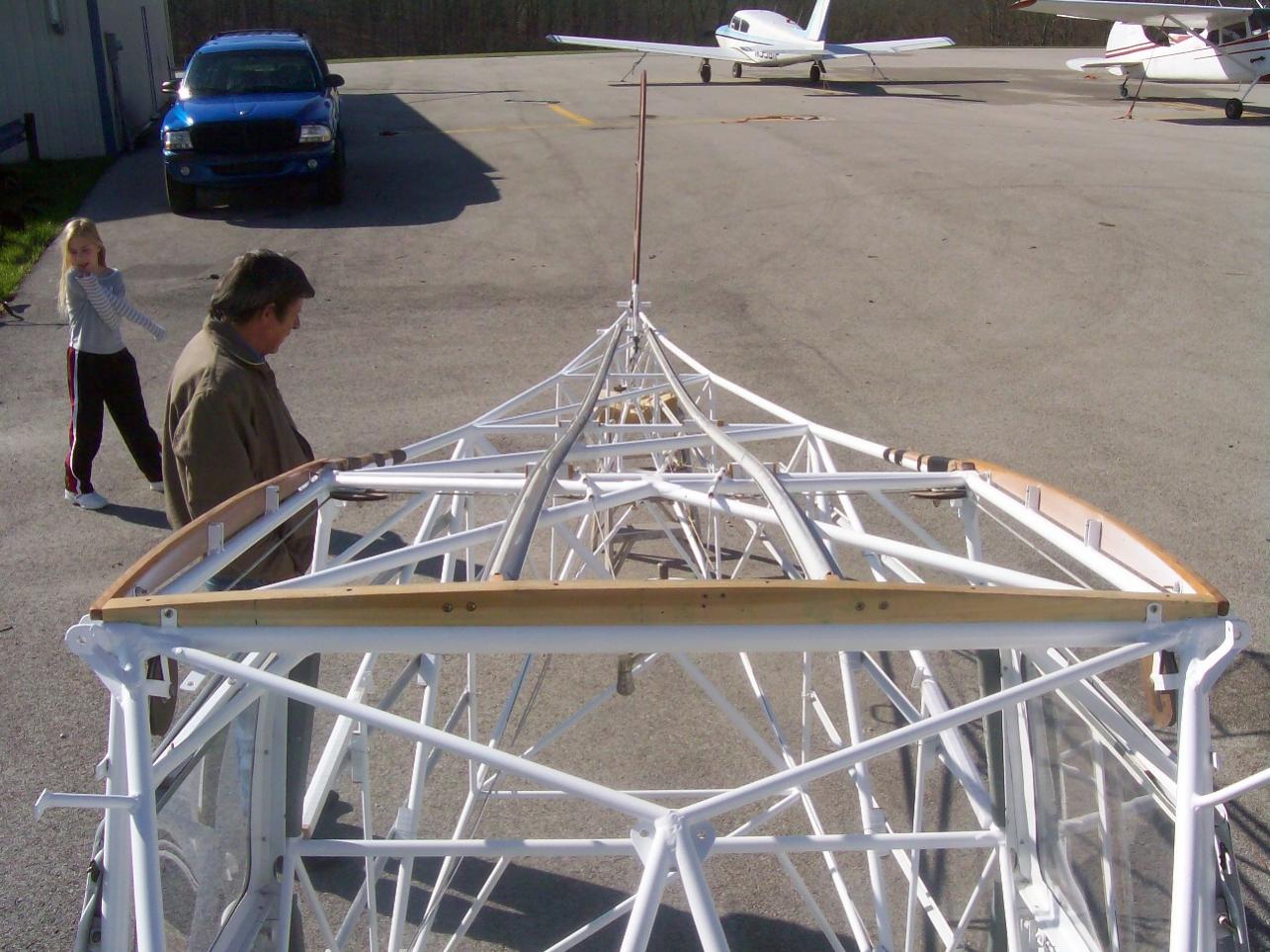

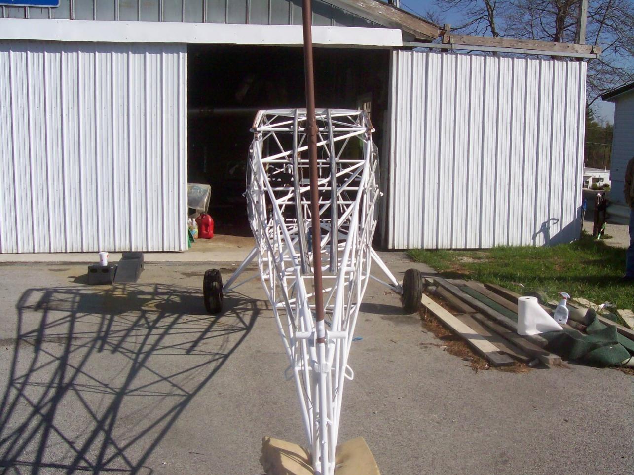

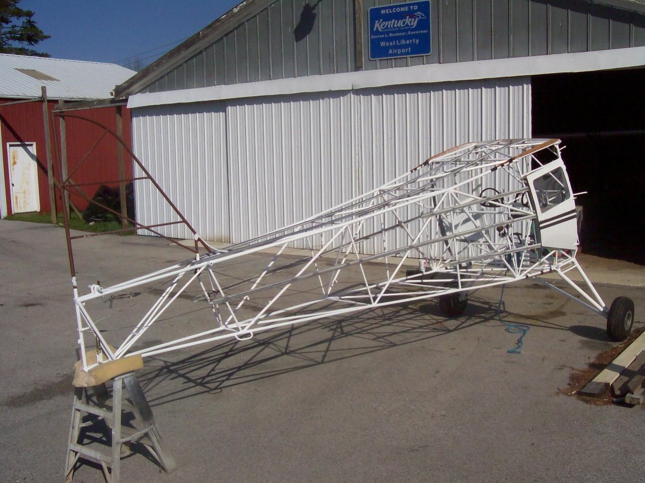

          Here is how we installed them on Crispy simply because that's how the wooden stringers were originaly installed when the airplane joined the family in the 1950's. The bottom ones are same as the top,two long stringers(I hadn't installed them yet when these pics were taken). We are not 100% sure that's how they were originally but dad said he was almost sure it was since the airplane was only about 10 years old when if came into the family but had been recovered at least twice by the time he was old enough to be involved with it.
              Kevin,
              Thanks so much. These were exactly the pictures I needed. Mine will only have one on the bottom but other than that I plan to set mine exactly as you did.
                glad I could help.
