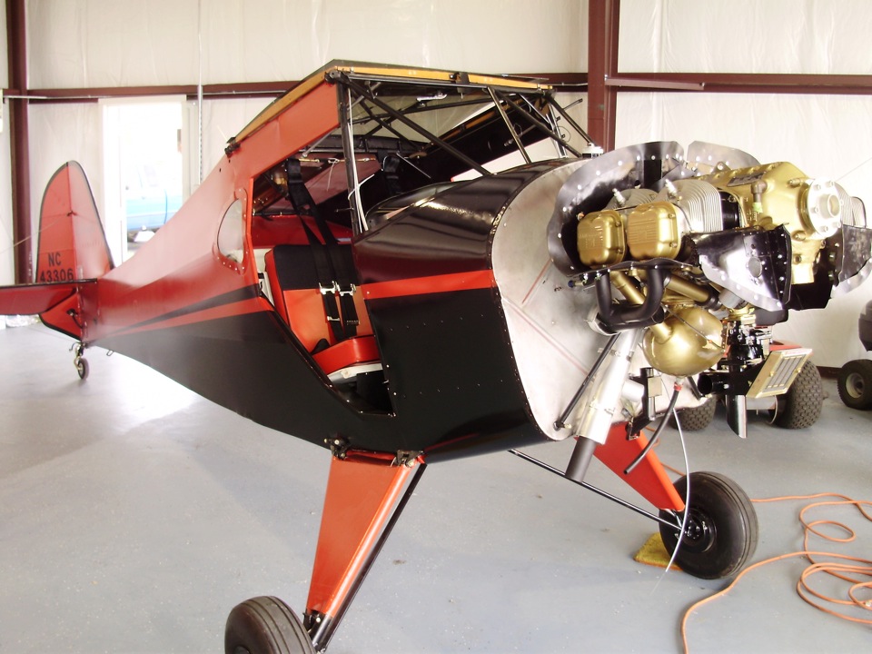

    Here are some pics of current progress on Doc's BC12-D.

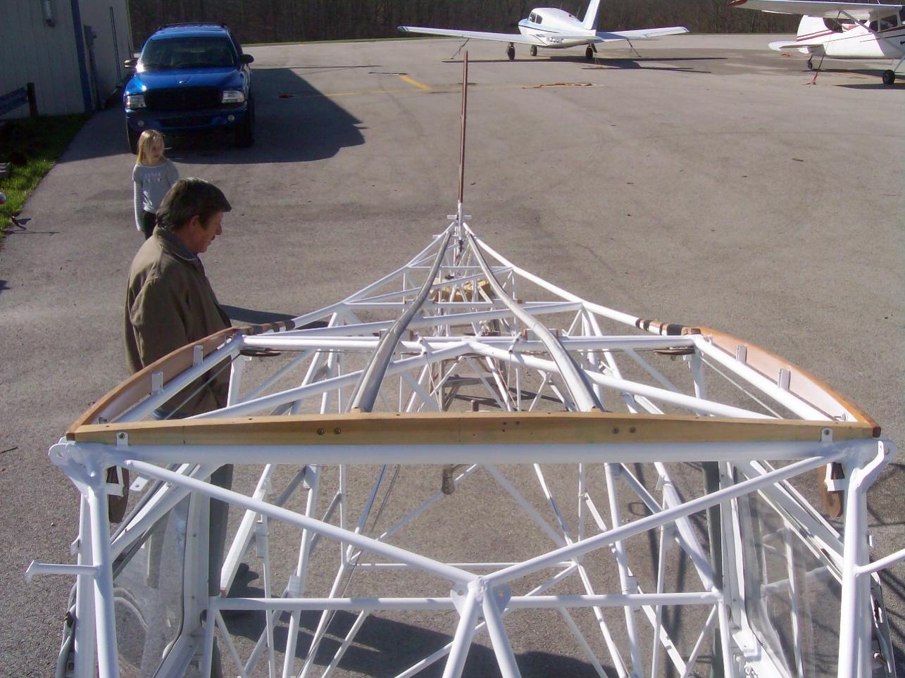

    The skylight is partially installed and waiting for a hot day to finish fitting it.

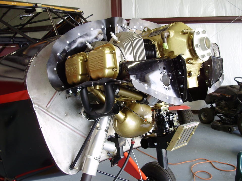

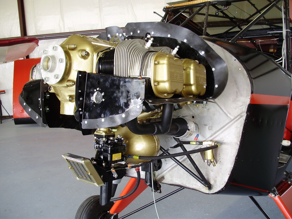

    Engine is hung and controls were connected as of today. Doc put a gallon of gas in the tank and :beerchug: there were no leaks in fittings nor needle valve. Four quarts of straight mineral oil are now in the sump and we will prime the oil pump before we start the engine.

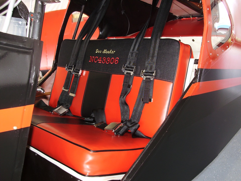

    The interior is installed with new seat cushions and Wag Aero four point restraints. I machine-embroidered the seat back and Doc had a local upholstery shop make up the cushions.
    A new windscreen will be fitted very soon.
    First engine start will probably be this weekend.
    NOS cowlings will be fitted after the engine test run.
    Two minor snags were discovered--Ercoupe spark plug cups will not fit into the spark plug wells on Millenium Cylinders. This is easily solved by grinding about 1/16 inch of material from two interfering cooling fins below each spark plug well. The original baffles had to be reshaped a little to fit Millenium cylinders.

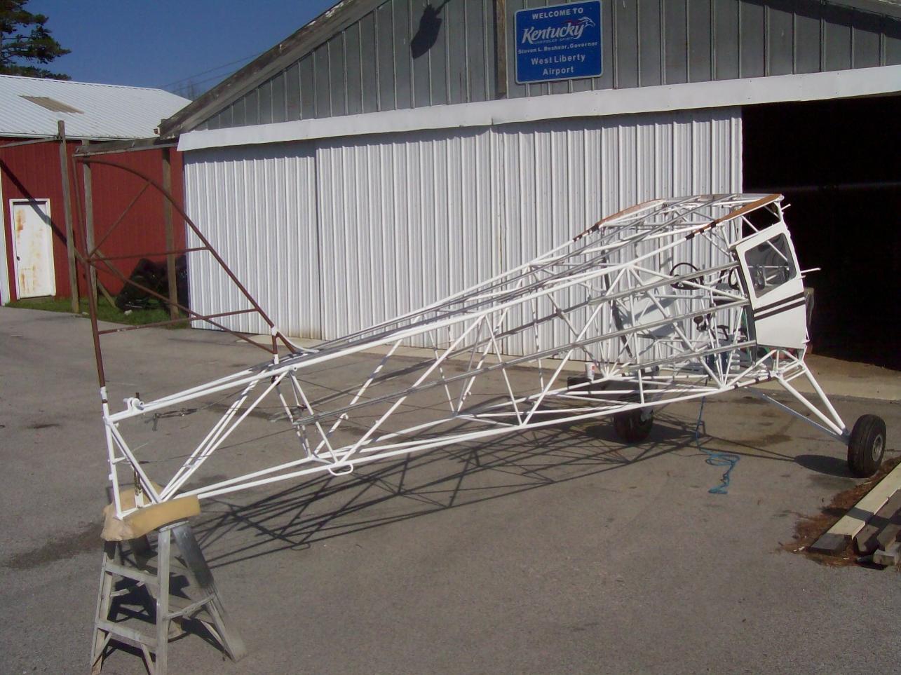

          Just glad I could help someone prevent the same mistake I made. Beautiful job on that t-craft. I have all the stringers re-installed on Crispy,hope to start sticking fabric in the morning. I'll try to post some pics this weekend.

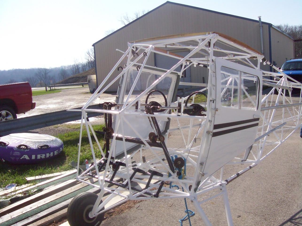

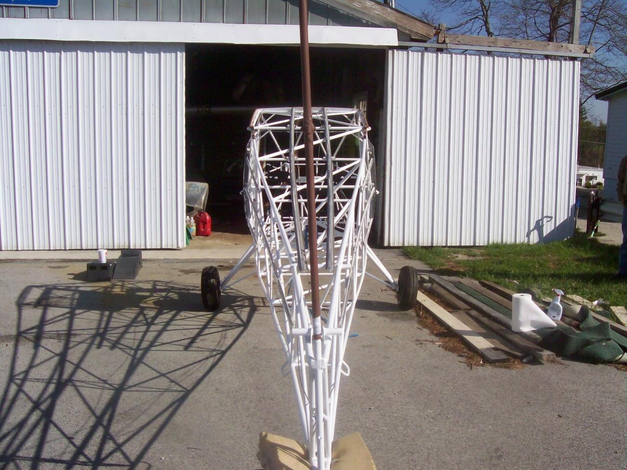

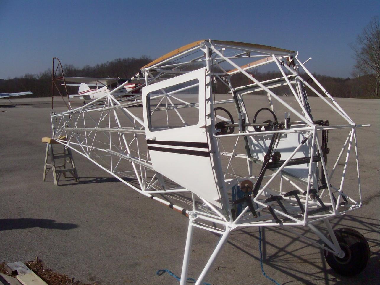

                Here's some pics of Crispy I took this morning.
                  Re: NC43306 Update
                  Looking good Kevin!
                  I'm sure the whole tribe is now doing a pre-cover inspection on Crispy.:beerchug:

                    Mark is being reticent today...we had some big changes. Lit the fires on the 0TSMOH A658F --> fired off after 3 blades, but no oil pressure even though we pre-oiled. Disassembled the oil pressure line system and verified that it was open. Finally determined that I had a defective new gage. I pulled a NOS gage off the shelf that tested OK, reoiled the engine through the temp sensor hole and the oil pressure line, and the engine fired up once again --> with oil pressure, BUT without any tachometer reading. So...the tach and engine attachments, and both of the right angle drives were checked, rechecked, and rechecked. Finally determined the tach drive cable was ~ 1/4 to 1/2" too short for the right angle drive on the instrument...we will rework. Did I mention the wrongly built Skytronic upper deck ignition leads? I have "Ercoupe cups" and supplied Skytronic with the original harness and asked that the plug nuts match the original upper deck leads. Both the original and new harness came back...the new uppoer deck leads had the wrong nuts. That part of the harness went back to California today. Oh well, we at least finished the skylight tiedown clips. Tomorrow...wings should be mated if our other halves give us the green light. Doc

                      Been thru to wrong nut for the cups. I don't think they have them.
                      If I can find my die I can loan it too you. With a little filing down of the
                      cup threads and using the die your'll never have the problem of the wrong nut. May be Monday until I get to the airport.

                          Thanks for the offer on the correct nuts...I sent my original nuts back to Skytronics and asked them (again) to rework the harness with them...we will see. Josh, the upside is no blisters...the downside is that the unshielded sparking plays havoc with your radio. I had tried magneto filters in the past...poor results. Since I like flying better than talking, I opted to go back to the short plugs and the cups on this rebuild. My cups are flat on top with threaded lids that can be safety wired. The TC we rebuilt last year had rounded cups with wire bails...very pretty. Most people have not seen the cups and always ask about them. Doc
