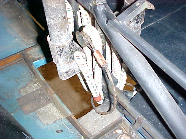

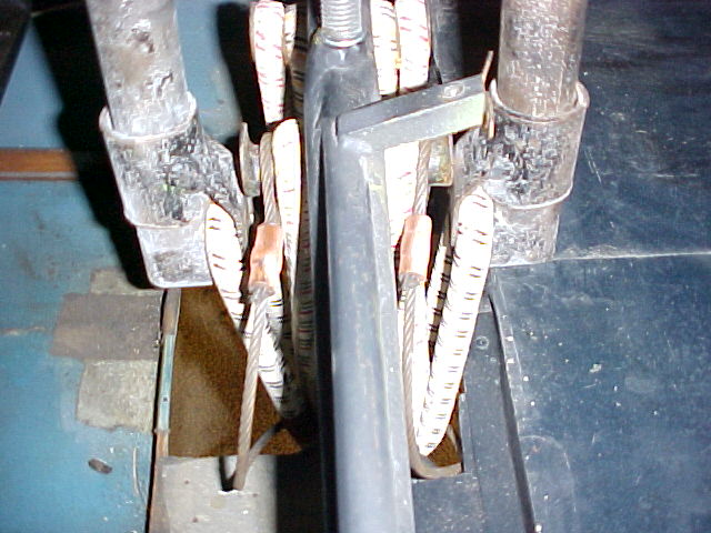

              If installed properly they will not wear the cords.
              Use Beeswax and let them stick to the outside in the middle like shown on the photos. At the bottom the safety is between the cords and barely touchs it.
              I then tie wrap the cord out to the side, It shows if a Student drops in a bit , it will break the tie wrap.

                      Forrest,
                      From your pictures I see the cable installed between the bungees. I assume that must be the correct method?
                      My cable was installed after the second bungee against the metal stop. I put it back the same way when I did my bungees. Is this wrong?

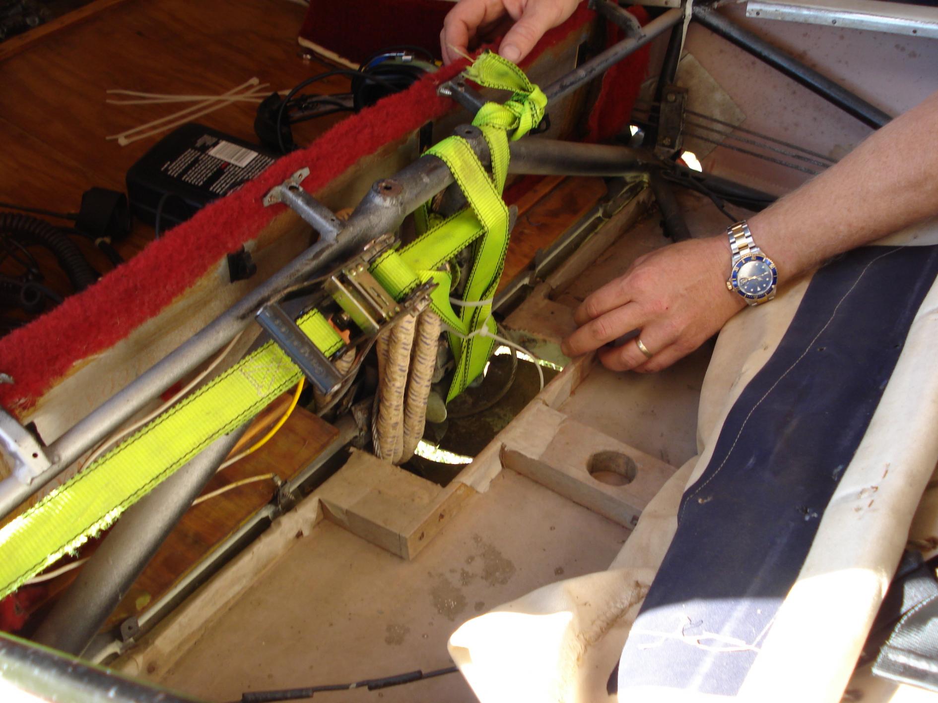

                          If the safety is not installed correctly , I would probably just wait till replacement time. YES middle is correct from factory instructions.
                          Removal is easy if youa vhe done a few large screwdriver or taper bar, not for the faint of heart. Just flip them off , BE CAREFUL. OR you can extend a shop crane into the cabin and slip a nylon strap under the first cord and pull up, slip it off let down , maybe cut the strap and you ahve an intact cord . If not saving the cords , cut them off of course. Some cords will de 'dead" and just sit there. The strap method is used on the Pitts Specials too. on and off.
