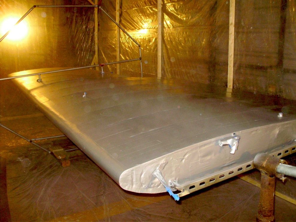

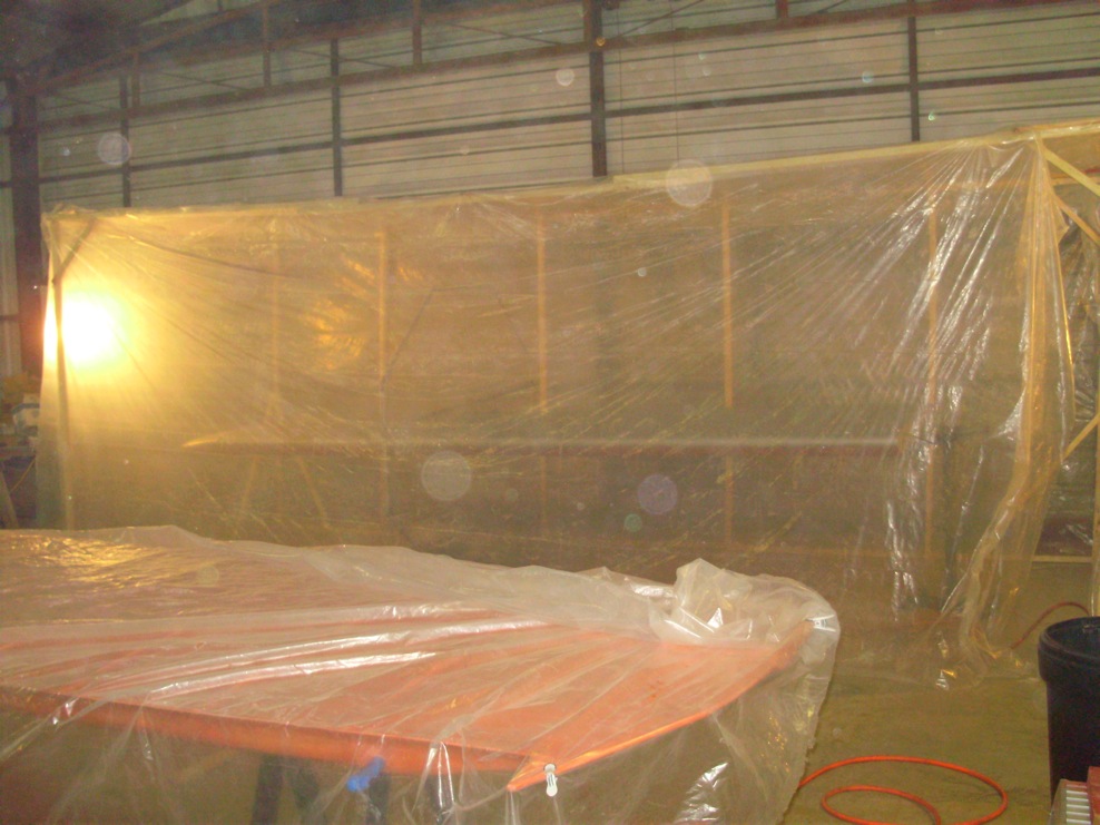

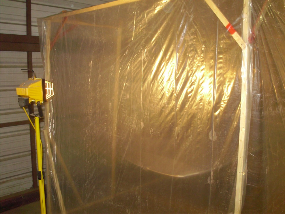

    We are finally getting silver wings on NC43306.
    Here are some photos showing our progress in Doc's hangar. Sorry about the poor quality. I'll clean the lens next timeops:

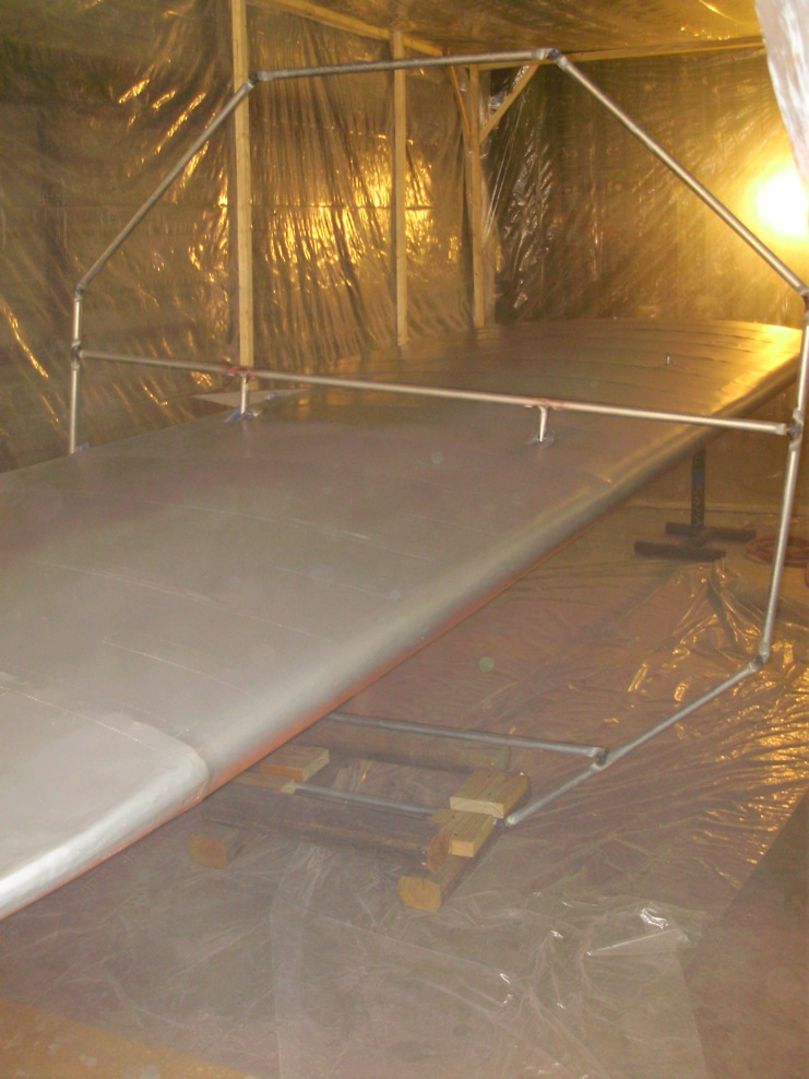

    The hoop fixture is made from three lengths of 3/4 inch electrical conduit and gas welded. With the two cross bars as stiffeners it strong enough to hold 200 lbs at any angle.

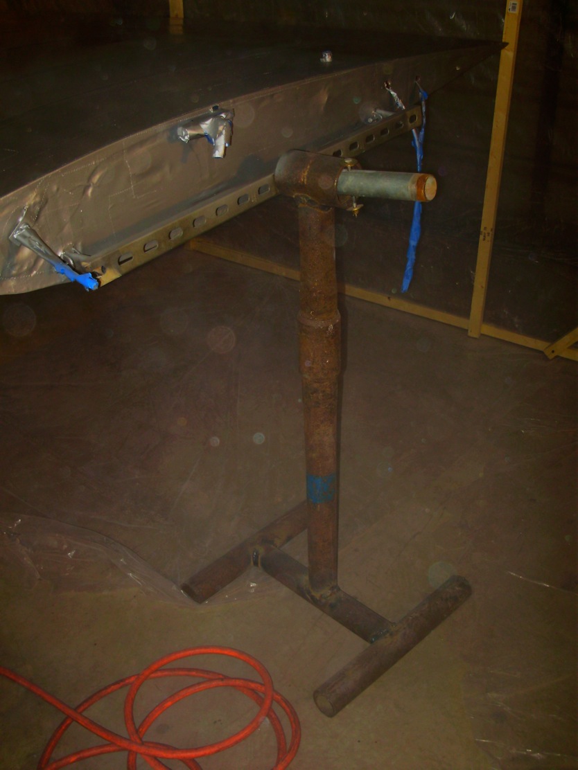

    The wing root fixture is left overs from several other projects and works fine although it is no work of art. One person can turn the wing over but must be careful not to tilt the hoop fixture or the whole shooting match can tip over lengthwise. A couple sandbags on the base would help.

    Congratulations on your progress! Go Go Go !
    The hoop fixture is a great idea, I had contemplated something like that for my upcoming project.
    I have an idea or two to share :
    1) Eight lengths of conduit welded to the hoop fixture oriented spanwise would prevent it from wanting to lean over even when the wing was "above" the jury strut fittings.
    2) Hanging the hoop fixture from the ceiling with a hook that slides around as you rotate the wing would also prevent it from tipping. Or a pulley large enough to match the hoop tube. This would work best with a circular hoop instead of an octagon, however it is do-able both ways. Of course you would have to disconnect the hook briefly when rotating the fixture past the cross-beam, but you can set the hoop down on the ground and balance it with one hand during this switch-over.
      Re: Silver Wings at Last
      Bill,
      Thanks for the great ideas.:dance:
      I think I'll add 4 lengths of conduit which will be enough to stabilize the wing in our case because I plan to shoot paint only when the wing is flat. The pulley idea is even better if I could find something overhead to hang it. I did not pre-plan for that where we built the paint booth but I love the idea.
      I was not clever enough to make a circular fixture. I don't have a bending jig and I don't know an electrician who has one handy, so bending a circle of 240 inches circumference was a bit daunting. I'm sure someone in the tribe will tell me how to do it easily.

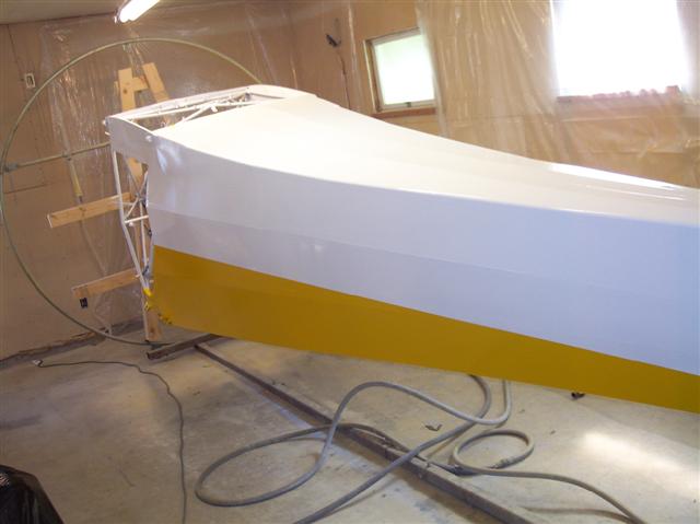

                        This is how I did the fusaloge.
