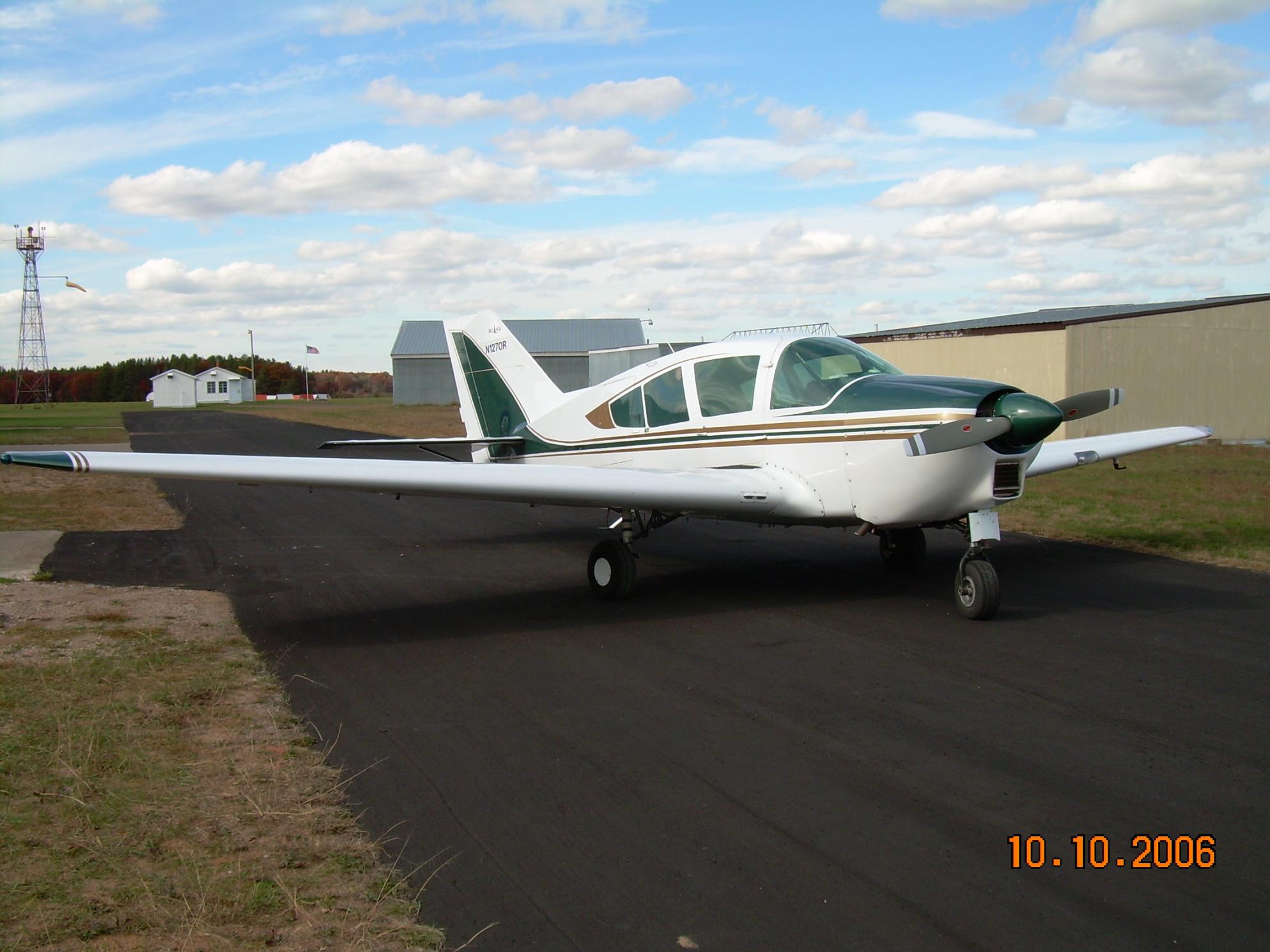

                  I have a couple of 66 Bellanca 260 single tail's. One is getting a facelift. I am always looking for the right triple tail project, I have faith it will show up when I have the least amount of money avaliable.
                  Dan
                    Re: V-Speeds
                    Yum, 66 260. One of my very favorites. Makes my mouth water. Weird thing, I have never been in a tripple tail, ever, I just love the design.
