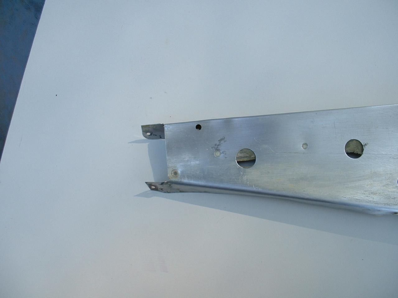

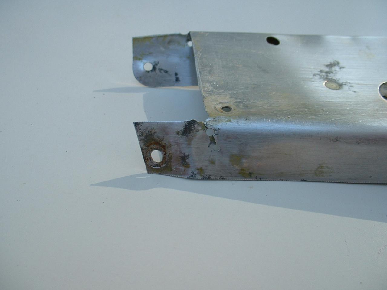

    Attached is a picture of the two tabs at the end of an aileron cove. The near tab developed a tear, had a "stop hole" drilled, but the tear continued, now extending at least 1/3 the way across the tab.
    Based on my previous exercise in reinforcing a part, it's not always evident how the forces are distributed and just how far the reinforcement should extend. In this case my first reaction is to simply overlay a piece of metal over the tab and continue along the edge of the main piece for about an inch. The piece would be as wide as the tab.
    Any thoughts on how to reinforce this weakened tab? - MIkeH

    What about making a dubbler what extends into the rib and and makes a NEW end of the rib and rivit it on if made properly you may even be able to remove the old and broken part of the rib.
    How mush you would have to overlapp I dont know but I bet you can find it in 43 -13. Len

      Len - good idea and that was my original thought; however, I have a habit of making things more difficult than they need to be so I was wondering if a simplier approach would do just as well. I'm trying to visualize the forces on that "ear". - Mike

        Looks like a prime candidate for an owner produced part. If you take the old part to an experienced sheet metal mechanic, he can probably whip a reproduction out for you in about 30 minutes.

          where''s the fun in that? I'm armed with a rivet gun and some aluminum sheet. Knowledge is the only thing I lack- Mike
