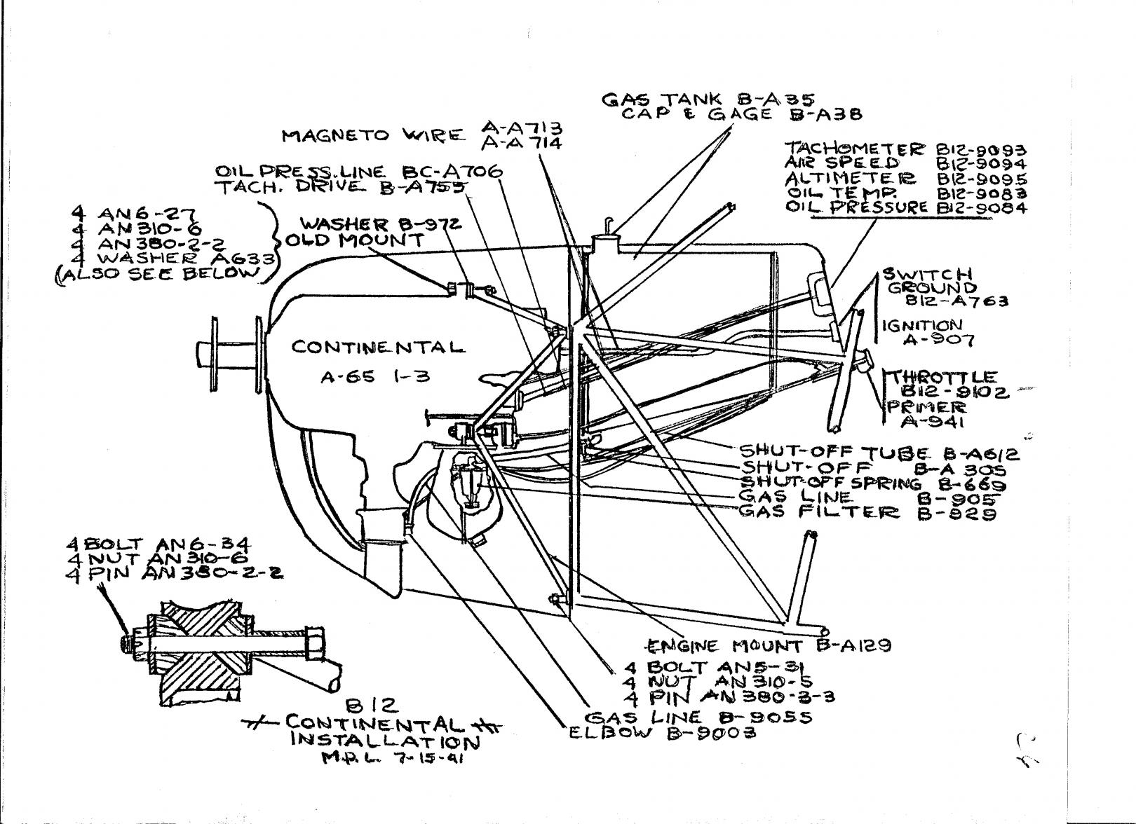

    Can someone give me a link to a photo of the correct assembly of an upper motor mount (without grounding connectors or other stuff) for 85 or 65 HP short mount on a BC12D. One that shows washer positions and orientation, ect.
    If not that, then a good description or a link to an offical source of information on the assembly.
    Thanks,
    Darryl
    Edit: I mean to say the rubber shock mounts and washers, ect.

    Hi Darryl, Here's a drawing. It's dated 7/15/1941 for a B-12, also shows older mount. Don't know about short vs. long??

      Thanks Howard,
      I didn't think of looking in the manuals that I have. Been some heavy stuff coming down around here. My older brother is the worst kind of ill. Kinda goofs up my thinking processes.
      That little side drawing is what I needed.
