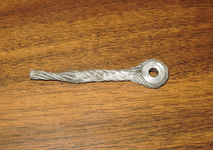

        From a 1947 Taylorcraft...
        • #34
          Re: Cable splicing
          Thank you Mark Julicher for the photo of the cable splice. I have added it to the course.
