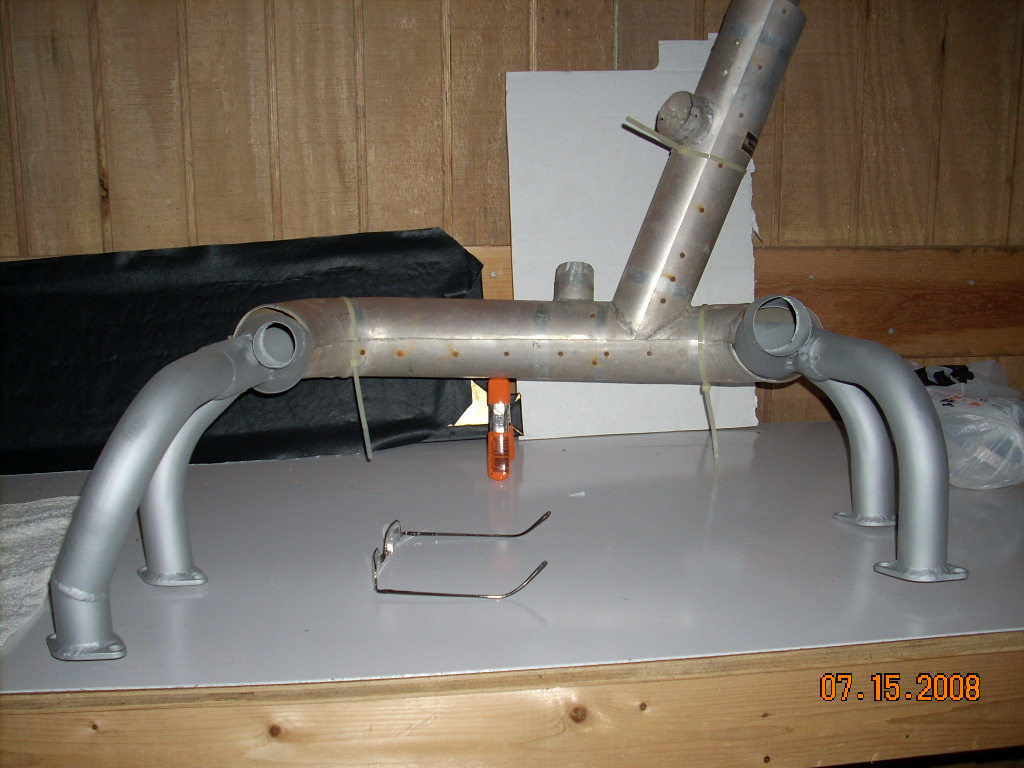

    What is the hookup for the intake air into the exhaust muff? Off the back of the eyebrows? Scoops ala Lyc.? Thanks. H

    On my open cowl L-2B it was off the eyebrows. Don't know about the side-by-sides, though.

      Thanks Marty, What's funny is that I've heard the B models didn't have the tubes on their eyebrows Although it would seem to be the easiest routing?? How did you guys do with the flooding in your town? Ok I hope..

        On the L-2's there are two tubes, one from each eyebrow if I remember correctly. I boughts two eyebrows from Forrest as my L-2 utilized a BC-12 exhaust and was not correct. The gentleman who did the restoration did a nice job of adapting the exhaust and forced air, but it just wasn't correct and I wanted to make it right. Never got around to it before I sold her.

          Thanks for the info Marty. I may end up poking holes in the back of the eyebrows ... hate to do that though if it isn't right......

            There has got to be someone here, or Forrest, that would know the correct way. I know when I was there last year he had the open cowls for the early models and I know he would be aware of the correct install. Try e-mailing him with your Foundation number in the subject line. With the fly-in over he will hopefully have some time, though probably not much.

                Don't use the L-2 setup with blast tubes off back of eyebrows. B series has different setup. I will send you some photos of ours. (It may not be original Tcraft. Maybe copied from cub. But gives optimal cylinder cooling.)
