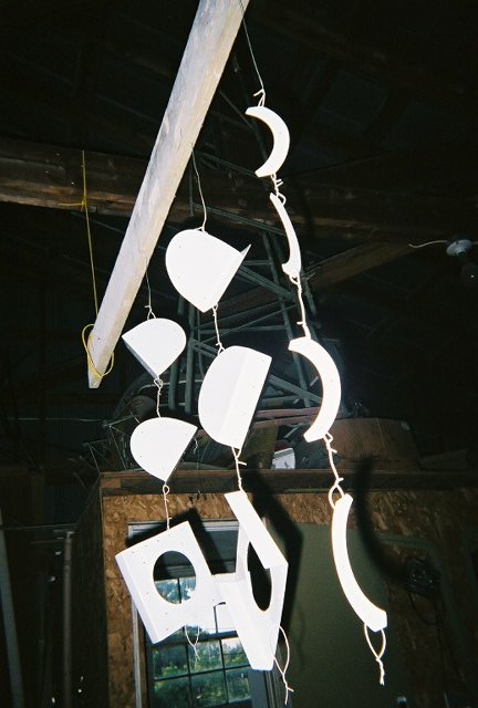

        I have 2 1X6 pieces of decking board 10' long. I drilled a hole in each end and hand it from the ceiling. I then have roofing nails drove about half way into the board with about half an inch sticking out ever 2-4 inches or so down the entire length of each board. I then use cheap safty wire to hang the parts from them......you can hang more then you can stand to paint/prime at one time. I'l try to find and attach a picture.
          Re: a smarter way to spray parts
          and you've made modern art!

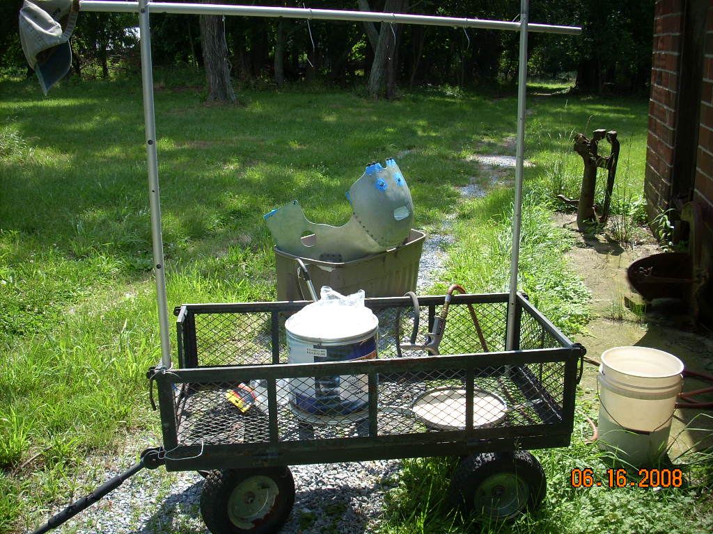

              Use this for painting, media blasting and hat hanger. Don't say anything about the grass not being mowed. You want to fly or cut grass???
