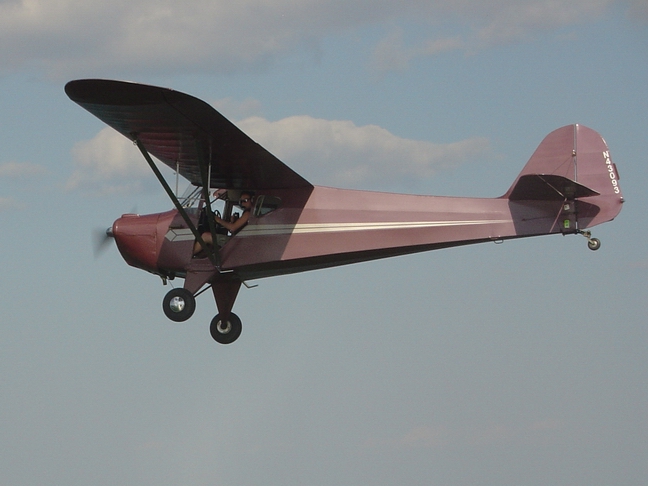

                Re: Flying doors off?
                Here is a pic....
