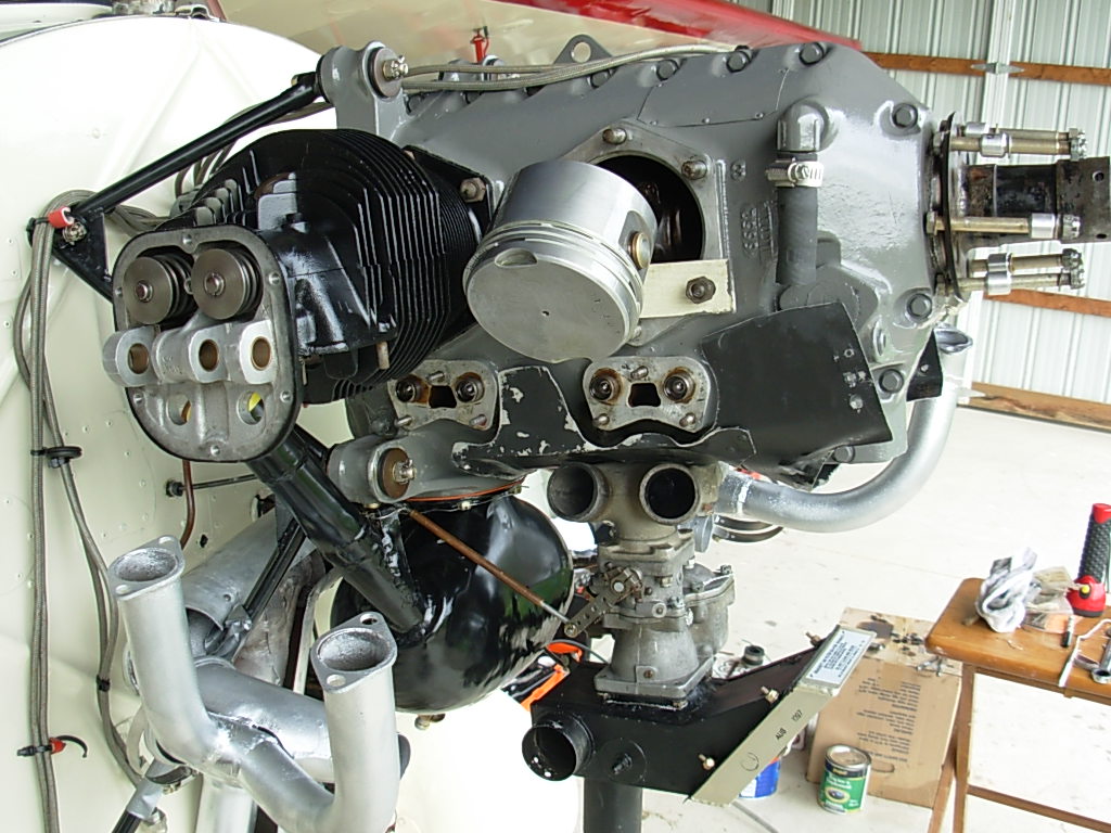

        Request: I would like a picture/drawing/anything on the "baffle" that goes (under?) the engine on the Continentals. I don't have one and my oil temperature is always weird. Like too hot in summer and too cold in winter. A 20 degree drop in temp will cool it down 30 degrees, seems like; and it doesn't get very cool here. Is there any info here or can someone post a picture? Original like, not a later modified or such. Thanks.

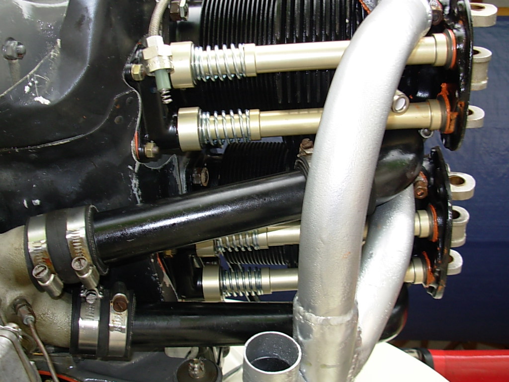

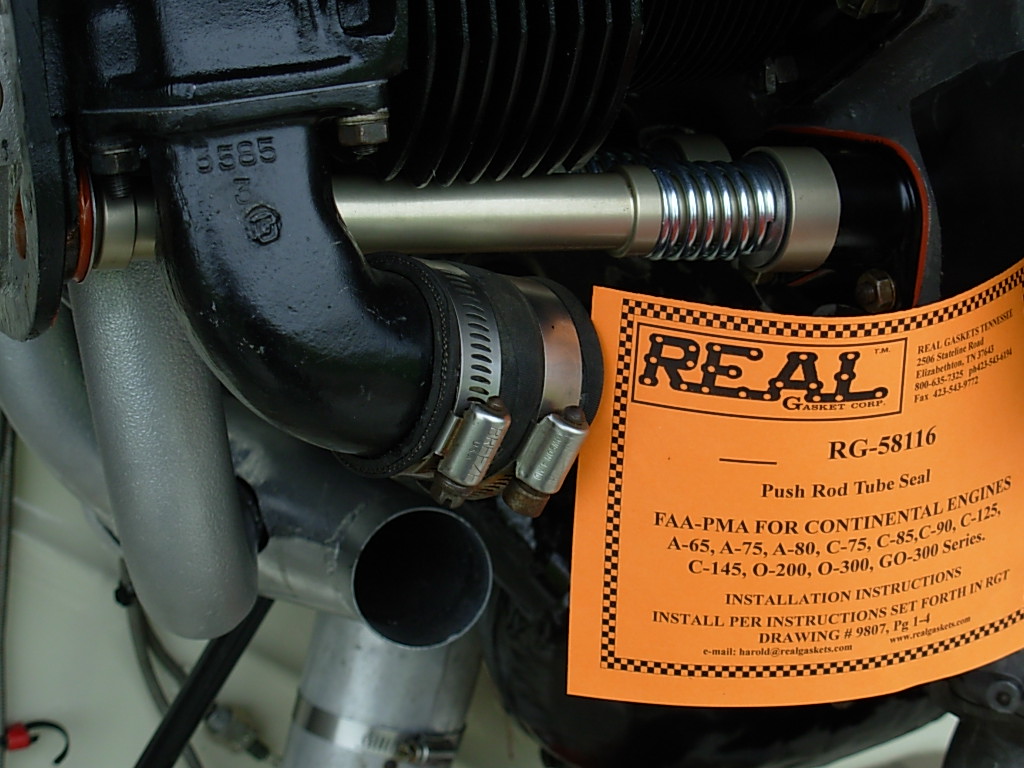

          Here are some pictures of the crankcase baffle. I believe a previous owner at some point did some cutting on it for whatever reason, but you get the idea. These pictures were taken to show my new installation of pushrod tubes.

            I was looking at your under engine baffle and it has a sharp edge
            However this should affect the oil temp and not so much the CHT unless your oil temp is running hat also.
            Oil temps are low now, thanks to that baffle. The sharp edge would possibly cause a separation in free stream, but in that application I think it's working fine because it is in a closed duct. There's nowhere for the separated air to go, it still is forced through that channel under the case. Obviously it would be a lot harder to build that baffle with a radius, but in this case the baffle worked wonders for the oil temp... like 30-40 degrees.

                David, thanks for the pix. That is about what I thought it would be. Now I understand the shape of the inlet on the front bowl.

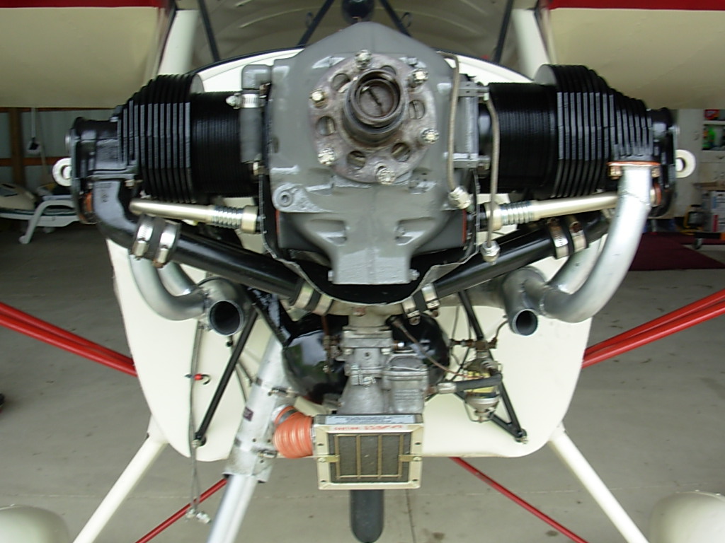

                    Hey flyguy, I should have posted a side profile also. Here you go....

                      Nice shot of the side. Thanks, that is a very helpful photo. Sure doesn't look like there is much room for the air to flow under the case. Maybe more space than it looks like?
                      Kevin, I have an 85 and I got high temps originally the same as Bill, that is, the two rear cylinders, say 400 to 450F., and then the hottest one went down when I opened up the clearance on the rear baffle on that side. (made it match the other side.)
                      Both hot cylinders go down some more when I block off about 3/4 of the air inlet in the lower center of the nose cowl, as I have said here before. That is running 100LL.
