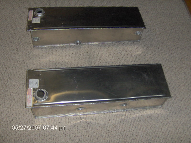

In case anyone else is interested...........WagAero is now selling new 6gal wing tanks. They did a nice job, exactly like the original I had (without the leaks!).
WagAero Tanks

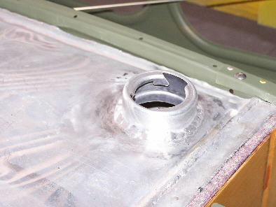

Taylorcraft used steel necks on the main and wing tanks, that were aluminum soldered to the tanks. It worked fairly well, however they are known to come loose. You can buy a new aluminum filler neck from Wag that is exactly like the original steel one and have it welded in a lot cheaper than buying a new tank.

They charge $425 a piece for the tanks..........but they are brand new. And the filler neck is aluminum.
I agree that there are times it makes more sense to repair a tank rather than replace it. But I had already had bought a used tank (sight unseen, my bad) then found bad thread fittings, had them replaced(new ones welded in) then still found another leak after that. Oh well, I learned a lot, but am tired of messing with 60yr old stuff. And I really don't want to have to tear the wing apart anytime soon. The new tank is still no guarantee, but I think my chances are better.

There is no special cleaing needed to weld on new filler necks. Just use a STAINLESS steel tooth brush all around the area that is to be welded, untill it looks like new aluminum. Same thing with the new neck. The old aluminum solder is very weldable and does not need to be removed. Do not try to flame weld it. Take it to good tig welder. He (or she) will know how to fill the tank with CO2 or what ever, so it won't explode while welding. This is really no big deal......a very simple job for any competent welder.
(I'm not even competent and my tank came out pretty good)
Bob
