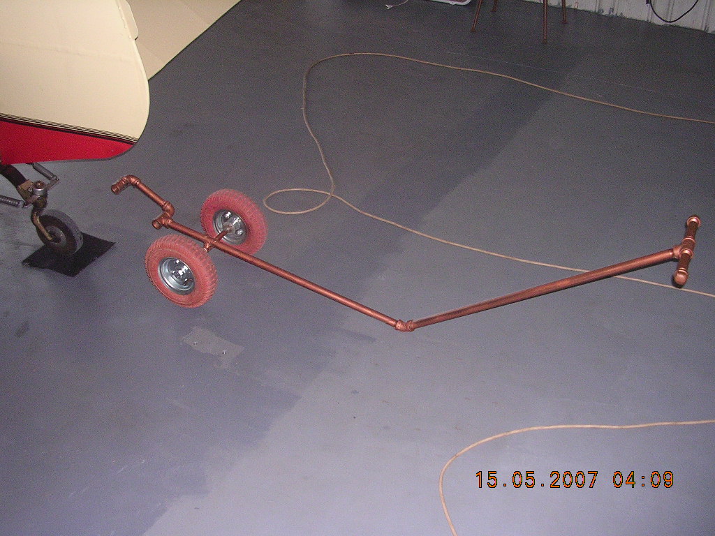

    Does anyone have towbar plans. Or a site to download a sets. As always
    thank you for time.
    Mitch

    See the attached towbar picture, I made it from pipe fittings you have to tack weld the fittings to keep them from turning. it works fine

      Re: towbar plans
      What about using JB Weld or epoxy on the fitting threads as you put it together.......that should work good too, no need for a welder!

        Re: towbar plans
        What are you doing over there?? JB would work except at the tail wheel lift points Walt

          Re: towbar plans
          whake
          What is the measurement of the pipes and what is the size of the
          pipe you used. again thank you for your time.
          Mitch
            Re: towbar plans
            Use half inch iron pipe and fittings,the wheels came from Harbor freight ($8) two 5/8 bolts and a coupling from Ace hardware for the axle, three five inch nipples, a 3 ft and a 4ft handle and a couple short nipples..
