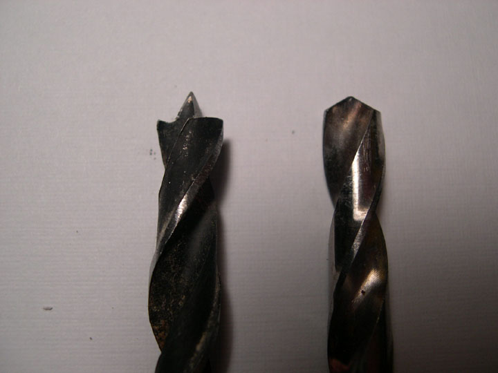

                    Sorry, Darryl, there's no reason you should recognize the term "brad point", it may be a regional term I picked up. The Photo below shows a "brad point" on the left and a ordinary drill bit on the right. The brad point (or whatever it's called) is designed for use on wood...the little point in the center serves to locate and guide the drill for an exceptionally straight and accurate hole. It's used for dowl joints or anywhere you want an exact size hole in soft material. If you try to use one on metals or fiberglass it gets dull in a hurry!
                    The advantage of the brad point drill bit for our Shinn brake applications is that the center point will follow a pilot hole...like the rivet-shank-size hole that you'll first drill when installing your brake linings. AND the outer part of the drill bit makes a beautiful, flat bottomed hole...just right for the rivet head. AND the flukes of the drill bit are sharp enough and at just the right angle so it'll easily shave away the soft brake lining material with only finger power (I wrap the shank of the drill bit with masking tape to save my delicate fingers). It's like a poor mans counter bore machine.

                      Re: Brake Lining Countersink
                      Thanks Bob,
                      The one that I have is actually a bit different and that is part of my problem. It has small triangular points on either side about in the middle of the cutting edge, so it leaves a small tapered edge on the hole. I modified a regular bit by grinding it off but it doesn't have good cutting edges at the correct angle. Since I am not in a hurry I'll probably look around for the real thing. I notice the brad point bits I saw on the net had little cutting teeth out at the edge. Don't think that kind would do as it would weaken the remaining material.
