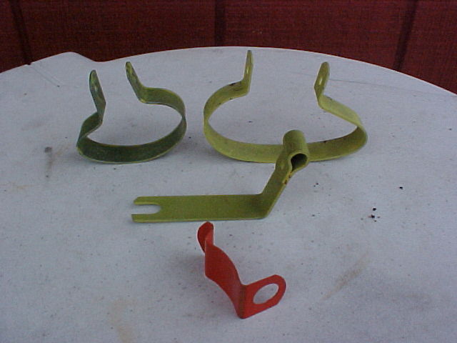

                    check the AD 51-09-03:
                    51-09-03 TAYLORCRAFT: Applies to All Series Aircraft Below Serial Number 13001 Incorporating a Pushpull Type Fuel Shutoff Control.
                    Compliance required not later than June 1, 1951.
                    To prevent accidental operation of the fuel shutoff valve during flight, a safety device must be installed on this control. The device is to prevent inadvertent operation of the fuel shutoff valve by requiring a definite and positive movement by the pilot before the control can be operated. Taylorcraft P/N B12-947-3 or equivalent is considered satisfactory. P/N B12-947 which was previously installed in some Taylorcraft airplanes must be replaced by this improved part.
                    (Taylorcraft Service Bulletin No. 66 dated December 6, 1950, covers this same subject.)
                    This supersedes AD 47-13-01.
                    I have attached a pic showing the B12-947-3 in the foreground, it takes TWO of these; OR "equivalent" to comply with the AD. I would say who ever installs the "equivalent" should sure document it in the Aircraft "Maintenance records". YES I was on accident investigations where the pilot turned the fuel off ; either this caused the accident OR he did it prior to the attempt at a forced landing. Look , feel, think, before moving things, then if something unusual happens for cripes sakes move it back again........

                          I have attached a pic showing the B12-947-3 in the foreground, it takes TWO of these; OR "equivalent" to comply with the AD. .
                          Forrest,
                          I'm probably gonna get hit with "dumb question of the year" but why do you say it takes "TWO" p/n B12-947-3 ?? I don't see anywhere in that text that it calls out for two of them... but I don't have the AD right here in front of me..

                            Re: Taylorcraft Accident
                            John,
                            That jumped out at me too.........
                            Forrest??
                              by definition the B12-947-3 ( made out of a spring steel) is indeed two of the one pictured that makes sure you do not mistake the fuel shut off for the carb heat . I only mention this because right after the accident; IF any investigator knows what he is doing he will blame any missing AD compliance for the cause of the accident.
