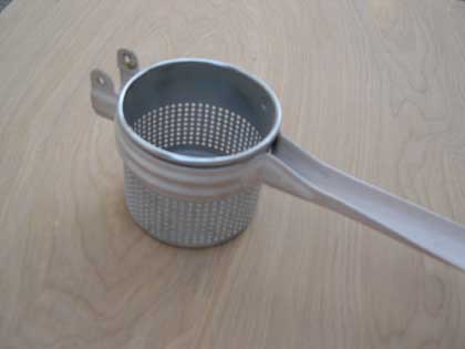

                  For small parts I use a 25 cent garage sale strainer shown in the photo. The basket is roughly 4 inches high and 4 inches diameter. I put the parts in the strainer aim the blaster nozzle into the open end and then just blindly blast away. The little parts jump around as the air blast hits them and end up being cleaned on all sides. Problem: sometimes very small parts will jump right out of the basket. Someday I'll make a cover for the strainer basket with a hole for the blaster nozzle.

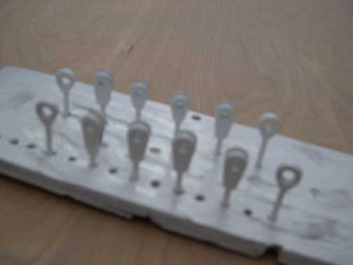

                  I've also attached parts to a board to hold them for blasting and also for painting...like the turnbuckle ends in the second photo.

                    The strainer shown in the previous post is half of a "potato ricer" in case anyone wants to ask for one at the local thrift shop. Do not. repeat: do not use your wife's kitchen utensils without very specific information being traded as to the potential for "some damage". (Don't ask...)
