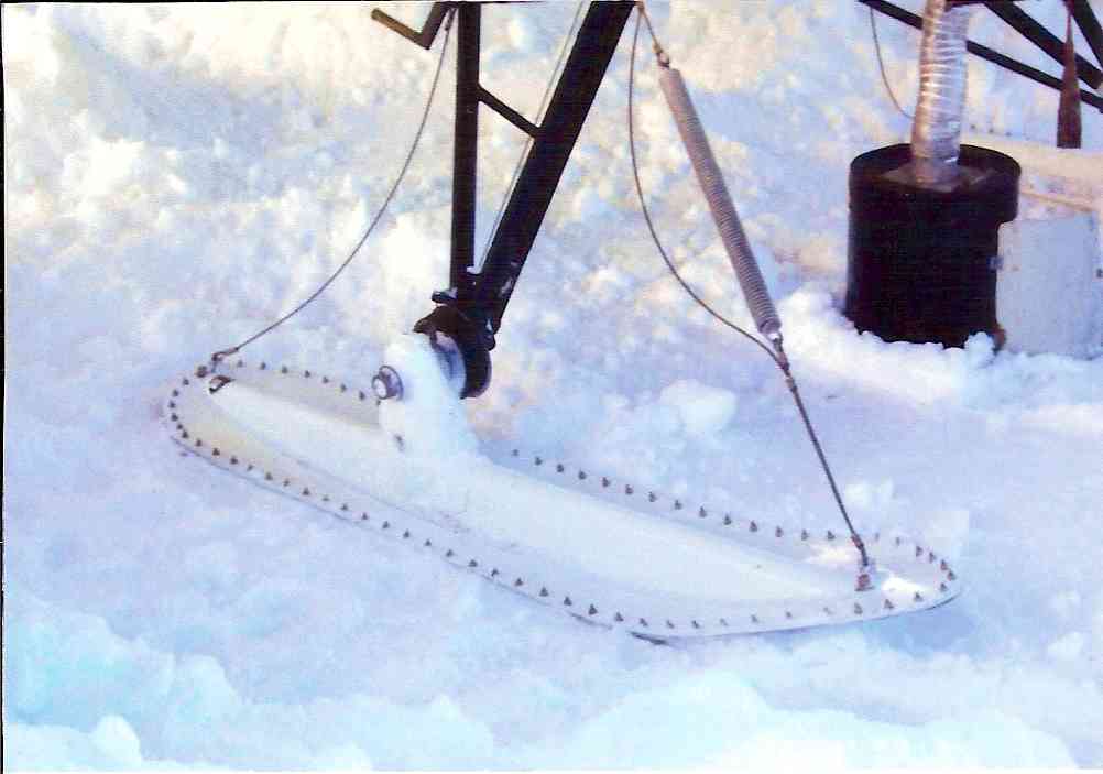

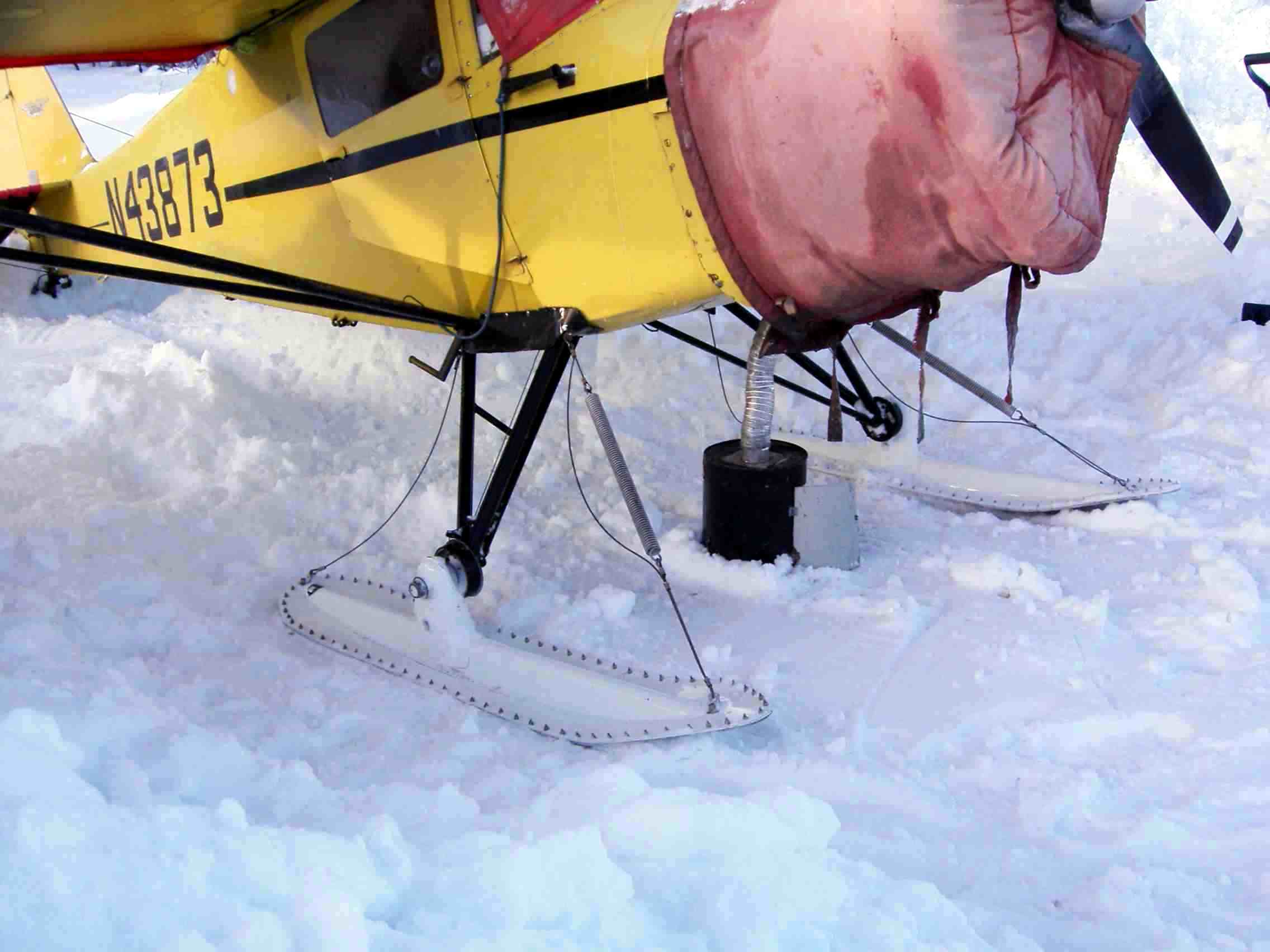

                Here in alaska i have seen about every kind of pre heater there is .
                Without elect, we are limited on what we can use for pre heating.
                I use a single burner colman stove that burns avgas or regular unleded fuel.
                I put the stove in a 5 gallon can that i made a door for... and have a 4 inch stack and use dryer duct to run from the can to the bottom of the oil pan.
                the thing you haft to do for this to work is to cut 2 inch holes all the way around the can nere the bottom. This dose two things it keeps the stove from getting hot and it makes a draft so the heat gose thrue the dryer duct.
                I have had this pre heater for about 15 years and i take it with me when ever i go on a trip where i spend the night. It takes one hour down to 0 deg
                at -20 about 1and a half hours.

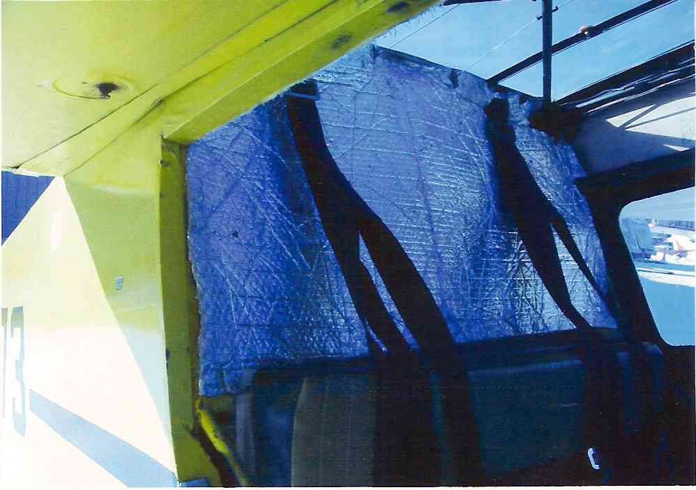

                I added a picture of my bubble type insulater for the inside of the cabin it works great for winter flying it make it so there is just the cabin to heat up..
                Lance Wasilla AK

                      I have use a preheater like the one Lance has pictured. I use a Coleman single burner dual fuel stove. The one I have fits great in a metal coffee can. I drilled some 1/2" holes around the can below the burner about every two inches. I then cut a square hole for the burner control and drilled a larger hole for the primer pump. A 6" to 4" stove pipe reducer fits perfect on top of the coffee can. I used a small 4" stub pipe out of that (8"piece). I too used the 4'' alum. dryer vent. There is a company that sells an approved version like this. I think they use a MSR stove. I think the company name is Northern Companion preheater.
