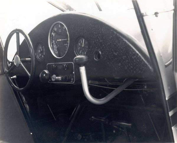

    2) On the lower instrument panel tube (the one that runs from door post to door post) there a two lugs welded on directly below the bushings for the control wheels. They are parallel with the tube itself. I thought they were for a control lock or something, but I guess you would only need that on one side. I'll try to post a picture of them.

    The primer sounds like the original. The throttle plate tells you to pull and release if you have that plate. The lugs on the tube are correct also, I beleive they were for the optional stck control. All I have seen for rigging is the manual which is brief. The control wheels were round originally. If you have any more questions feel free to ask.

        The primer is original,I have the same one on my '38.A bearing bolts to the lugs for a stick control.I have pictures of one somewhere.It's really quite neat.If you want pics of anything,just let me know.

          Thanks for the info guys, I sure would like to see a drawing or photo of the stick control setup if anyone knows of a link.
            Re: '41 BL questions
            or www.rodmanlibrary.com go to Alliance Memories & search taylorcraft stick control?

                Here are three of the over 500 pictures at the Rodman Library site, all due to the TAYLORCRAFT FOUNDATION !!
                The library used us to get a grant to do the scanning, lots more coming.... Does any one look a this remarkable resource for the older ships. WE will do newer stuff soon. Join the Foundation please!
