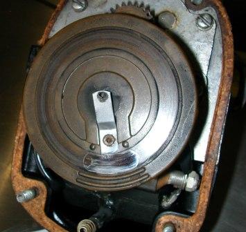

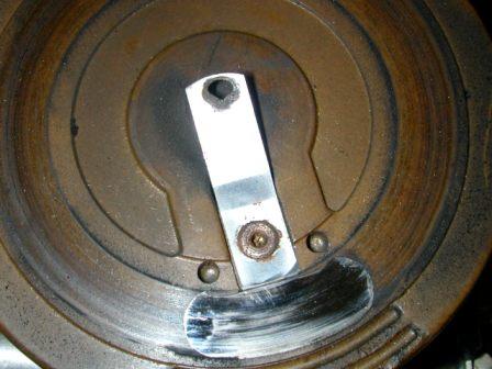

    Got one of those phone calls you dread from the mechanic when my plane went in for her annual inspection today.

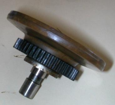

    When he opened my Case magnetos, he discovered that the central contact strips on the rotor disks had holes burned in them. (Probably years ago.) This part is about a quarter-inch by one inch strip of metal riveted to the plastic rotor disk that touches and rotates on the central contact in the distributor cap. Apparently, they've been arcing and have holes burned about halfway through their width. Can't replace just that little metal strip, because it was apparently riveted in place before the plastic disk halves were bonded together. So I need to replace the entire rotor disk units, which include a Bakelite? gear and metal shaft. (See attached photos.)
    Does anyone have some old Case 4 CAMA magnetos gathering dust on the back of the workbench that you would sell? Or just two serviceable rotor disk assemblies?
