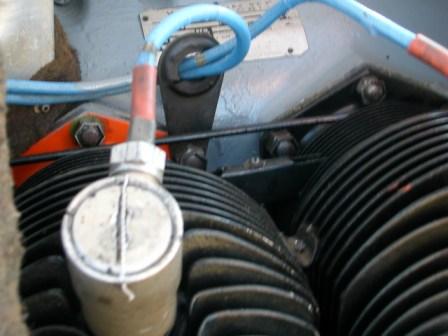

      Took this photo of shielded ignition cups on someone's BC12-D engine at Oshkosh two weeks ago. He said they were made for Ercoupes. Sorry, don't know where to find them.
      They were short enough to fit under the original cowling, without needing cut-outs or bumps on the cowl.

            Hi mgold, please do a search of this forum for the "eiseman magneto" thread and you will find information I posted on how to install the shielding cups. If you buy the ones from Fresno, they will need to be modified. It is pretty easy to do. The pictures I posted in that thread should tell you the story.
