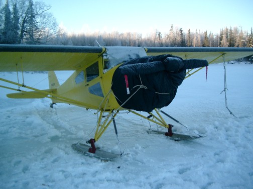

      Mike, you might go down to the thrift shop and buy a few old quilts and blankets(warm ones). You can rig up a passable cowl cover using several together. Buy a cheapy space blanket(the little one-time use survival type). Lay the foil space blanket over top of the engine cowling and let it drape down, especially over the grills and prop opening. Have enough blankets/quilts available to completely wrap the engine cowling, so as to prevent warm air from rising and escaping anywhere. Wrap a blanket around the prop blades and the spinner. You will eliminate a lot of "radiator effect". In the included picture, you can see how "wrapped up" my plane is. There is a fan/heater inside. Also, I pull the bottom rear of my cowl cover up, by wrapping a rope or bungee cord around the boot cowling, to close off the opening under the engine boot cowling, where the hot air comes out in flight. When it's really cold, during the heating process, I use foam rubber strips to seal off this lower opening. Be sure and remove "all" such material before starting the engine. I don't add heat to the engine compartment when the nose tank is clear full, to avoid expansion and overflow of fuel. Also, if you have a leaky wingtank valve, that fuel can move down and top off the main tank. Something to think about. Dick (P.S. Thomas answered you while I was typing this response...he has it right. It takes a while.)

          Why did you wrap the prop? You said 'radiator effect' - are you trying to minimize loss of heat via the crankshaft out to the prop?
          That sounds extreme, but that's how I read your comment! - Mike

            Regarding the prop covers, several years ago, Northern Pilot magazine covered some tests done on various makes of engine covers, with their various types of construction, materials, etc. They used some very sensitive instruments to measure heat loss. The prop blades showed up as definite sources of continuous heat loss. Since they are directly tied to the flange & thus the crank,, they contribute to whatever bearing clearances exist under the given temperature. When it's really cold, the engine is just plain tight and I believe it's a function of clearance as much or maybe more than thick, stiff, oil. Dick
