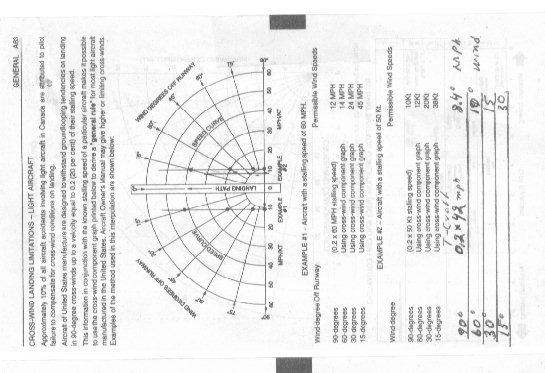

                        Here in Canada we have somthing called crosswind limetation in form of a Kosh chart, calculating on the angel of the wind to the runway.It gives you the max windspeed at a given angel. It is calculated at 20% of stall speed for a 90 deg crosswind.
                        My beloved/some time hated tail twisting ---- Taylorcraft stalls at 42 mph IAS 20% is 8.5 mph.
                        If stall goes down to 35 I have 7 Mph max crosswind .
                        Now take old low time pilot like me 200 hr TT and not being good at wheel landings, Do I want VG's ? NO!
                        If I was on floats? Yes
                        Does the chart hold true? Does for me! My limet is lower than the chart!
                        Just my circomstances.

                          Len - Your chart is broken. The Champ stalls just under 40 and runs out of rudder with a bit more than 20MPH direct crosswind. I've tried.

                            Thank you, Len! Good information. Objective. Numbers and a chart. The old engineer in me gives you a big thumbs up.
