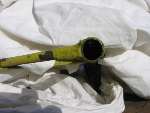

    Mike , Sorry for the poor quality. I sent you PM and I will post more( better) picture tonight. Rob
    I think we've resolved the problem; sometime in 88M's history, someone cludged this up; I cleaned it up a bit and can see where someone put a nut in there for some reason. simple solution will be to cut out a 3/8" gap (the OD of the trailing edge tubing) in the cludge, weld the trailing edge in place and put a finger strap around the whole she-bang - Mike

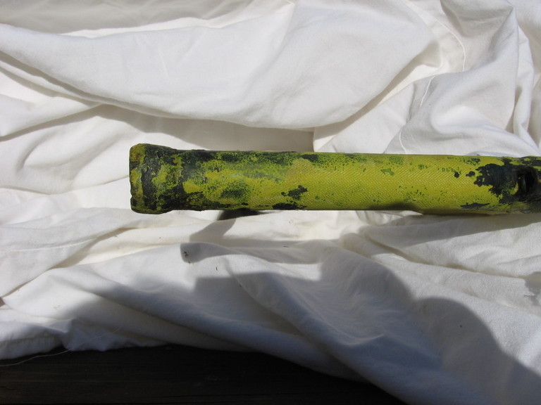

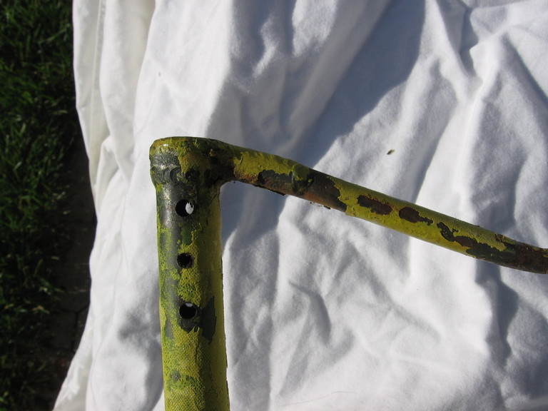

      Mike , here are some more pics. Rob
        Re: Could paint make up the difference?
        Execellent
        Thanks - Mike
