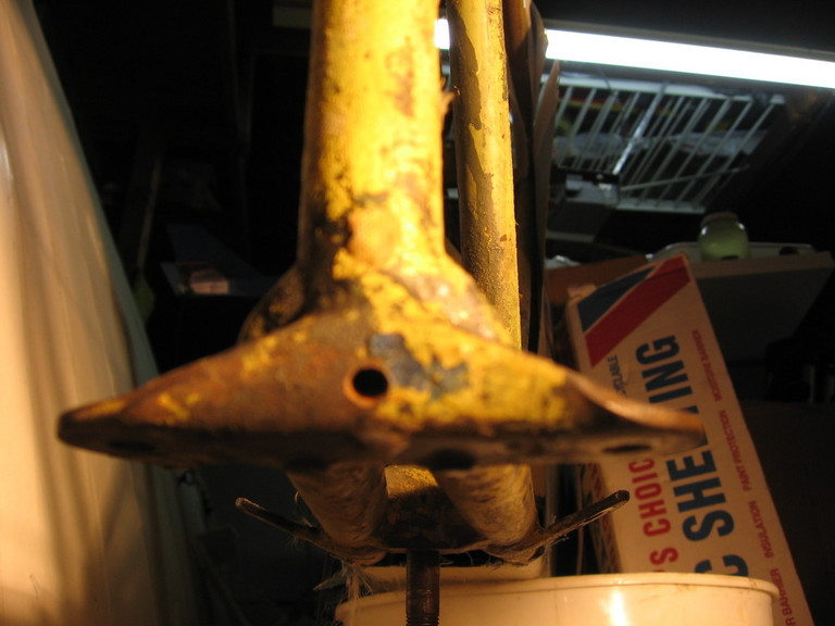

            Hi Rob, there is supposed to be a vent hole located at the bottom of the aft side of the tailpost that drains the the H2O from the two lower longerons. Dave.
              Re: Oil in tubes
              Thanks Drude, It was filled and coverd with paint, so I could not see it.
              I cleaned it off, and ran a welding rod inside.A small amount of oxidation/ slag the type you see from welding came out.
