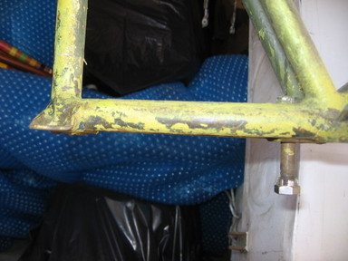

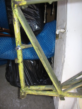

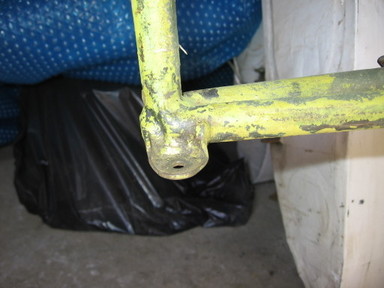

                            Here are some pictures of my rear fuse. It looks clean ,no rust or damage.
