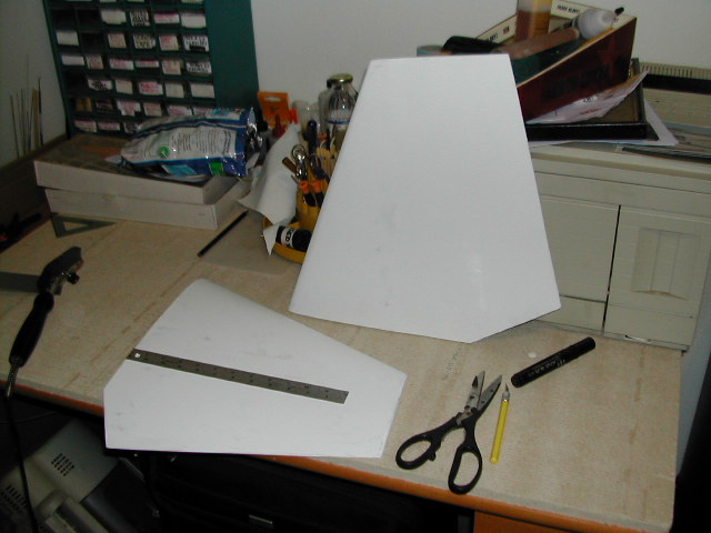

                                I've made three flights with my second generation new trim tabs. I added area behind the pivot, rounded the leading edge to a more blunt radius, and tightened up the bolt at the actuator lever for more friction.
                                The results at this stage are that the airplane now has WAY more nose-down trim than it could ever use, I actually will need to put a stop bolt or some other limit in place. I believe that the new trim tab has given me about 1-2 mph more cruise speed. Not much... but better than a sharp stick in the eye.
                                The newly enlarged tabs now allow me to slow the airplane down to about 62-63 mph on final approach. But this is not slow enough for an airplane that stalls at 38-40, and that others here say that they approach at 50.

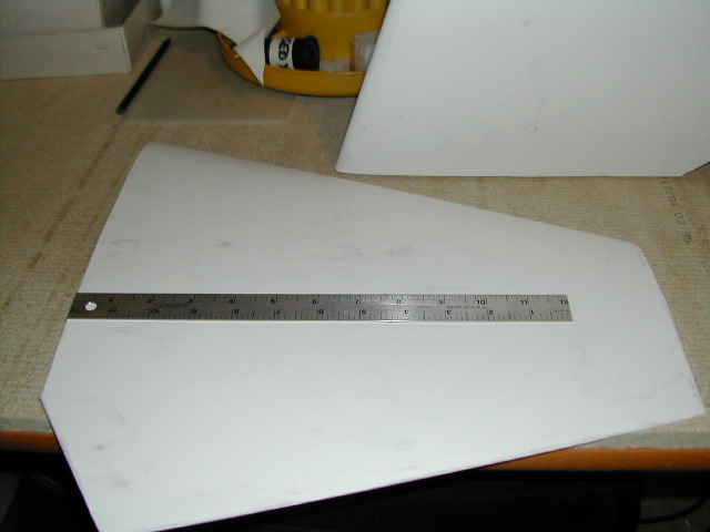

                                I do not feel comfortable making the tabs bigger than they are now. They look huge as it is (see photos), and I don't want to overload the structure or get into a flutter issue.
                                If I make a "final" set of improved tabs, I will do the following things differently:
                                Symmetrical airfoil or even slightly inverted camber.
                                Planform outline to more closely match the stabilizer/elevator shape.

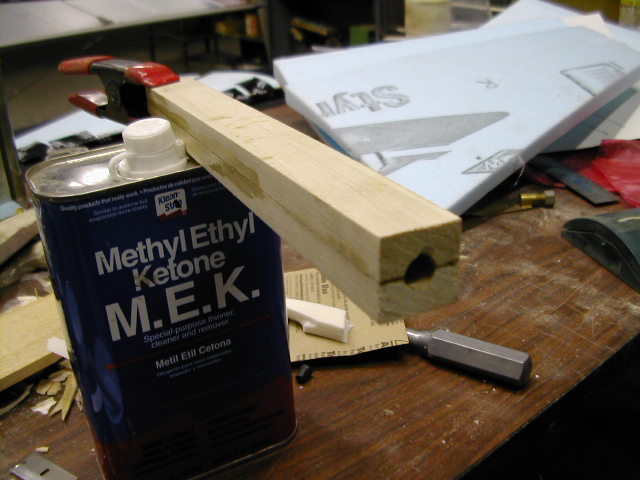

                                Wooden block spar and ribs but aluminum outer skin
                                The existing experimental set of tabs works crudely and allows me to operate the airplane better than before, but they are crude, not very attractive, and not even equal in size. Since the airplane flies better than it did and I solved the initial problem that made me start this whole thing, I intend to work on some other more pressing projects on the airplane, and re-visit the idea of a pretty set of trim tabe a little while later.
                                Here are a couple of photos of the tabs before paint. The wood block is the "spar" and load bearing portion. The thin metal rectangle is a 12 inch ruler.
