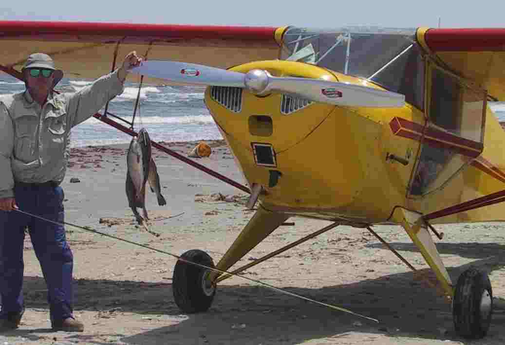

      My hangarmate has clear doors. I'll try to post a picture here. WHen he refurbished the airplane, he debated whether to reuse Plexiglas (which had cracks at every attach hole), or change to Lexan (which doesn't crack but may impede escape in the event of a crash).
      This picture was taken a couple of years ago on the Chandeleur Islands, a great place to land a taildragger and some specks and reds. I'm not sure that the Chandeleur Islands exist anymore since Hurricane Katrina.

            I knew that you would ask me the Lexan or Plexiglas question before I could find out for sure. I haven't been able to reach my buddy yet. So I don't know for sure which material he used. I think that it's Lexan. And it was about 1/8" thick. But I'll find out specifics.
            He bought the airplane with these "observation-type" doors already on it (with Plexiglas). But I'll check on what paperwork he has to go with the doors. The frames of the doors are very lightweight welded steel construction (thinwall square tubing).
            When he took the old Plexiglas off and installed the new plastic, he drilled the oversize holes in the plastic very carefully and used rubber washers on either side of the plastic at each attach point.

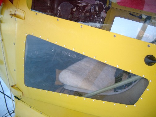

              The door cutout is quite common here in Alaska. I did it under a 337 a number of years ago, rather than an STC...I've never seen an STC for it as such. I used 1/8 " Lexan as the glazing material, rather than Plexiglas, although either will work. The Lexan is tougher, and seems to be less prone to crack, but it is clouded by contact with gasoline. I used pop rivets from the outside in, with very thin alum. washers on the inside of the Lexan sheet. Filled the rivet snapoff holes with appliance touchup...will paint someday!! Some use screws with washers and nuts, but I didn't like the rough surface created by the nuts. The alum. washer with the swelled head of the poprivet(used shortest rivet that would do a proper job), presents a much less ragged "sawblade", in the event of a crash. Be sure and allow for holes in the Lexan or Plexiglas that are large enough to permit expansion and contraction around the rivets, otherwise you will have cracking occur. It doesn't take much, but if you don't allow for it...you will get cracks. Practice drilling holes on scrap...buy some extra or save your trimmings. When it's twenty-five below Zero (Fahrenheit) I know my Lexan has really contracted, but the larger holes seem to compensate. Make up a scrap piece with your chosen hole/screw or rivet combo...put in deepfreeze to chill...take it out...bang/twist/try to get it to crack. Another thing...when you start fastening the poprivets or screws, if that's what you use, have the door in place and and closed, so the door has the plastic sheet oriented with the "twist" or "set" of the door when it is closed. You don't want to get the plastic fastened on and find that the door is "wracked" out of alignment by the trussing effect. After you get some rivets in place at the corners and a couple along each side, you can work with it off the plane. I also try to avoid getting gas on the lower part of the door, as it will get cloudy, but I like the strength of Lexan. I use Plexiglas on the upper window. If the Lexan on the lower cutout section gets cloudy and I get tired of looking through it, I can replace it, but the toughness seems to stand up well to the closing/flexing of the door. I've been told by the guys that sell the Lexan that some of it has been treated so as to not absorb gasoline, but that cutting it exposes an untreated edge that can absorb gas. I figure that the cut edge is on the inside of the door, so hopefully it won't be a problem. Hope this helps. By the way, I'm planning on replacing my Lexan skylight with plexiglas, as refueling in high winds has proven that gasoline will cause crazing/cloudiness of Lexan. It is very tough, but it will craze. DickSmith N5207M TF#159

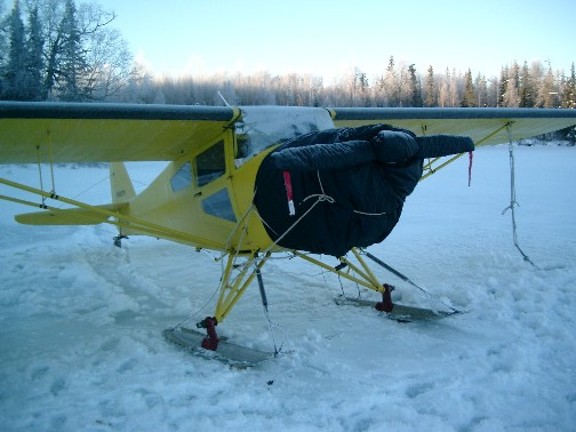

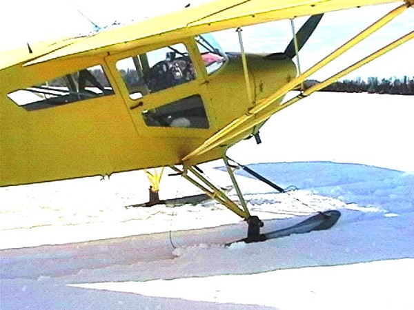

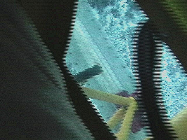

                    Re: Plexiglas/Lexan mods
                    John, of all three mods: door, sidewindow and skylight...I would rank the skylight first, sidewindows, second and door cut outs 3rd. I use the door cutout especially when I'm alone and looking to the right. This pix shows the view of the ski standard looking through the door cutout. I really like the skylight, because I can clear the area above and see over the top of the wing in a fairly steep bank. I think the skylight is a major addition to safety. The net effect of all the mods makes the plane feel a lot more roomy and the lighting levels are much better. Up here light goes a long ways toward making life enjoyable. One negative is that you lose a lot of heat through the glazing, but there isn't much to begin with! Dick
