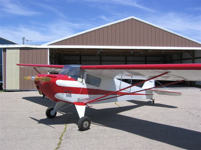

      I know that airplane if it belongs to Everett Anderson and is red and white. My IA recovered it. It is very nice. Here is a picture. I taxied it around in August...a friend was looking at it...he didn't buy...I almost did. It has an A65 and a wing tank...very nice plane 776# empty.
