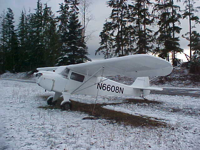

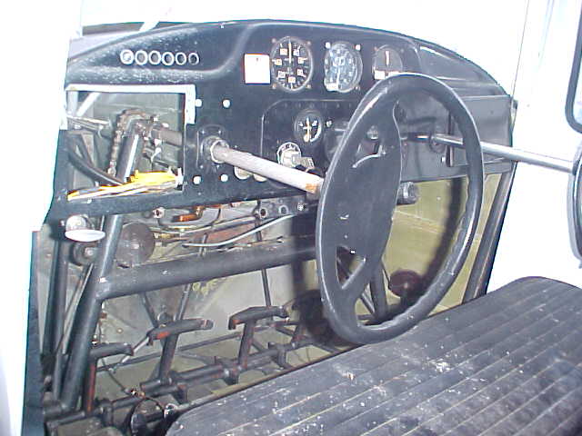

                      Here's a couple of pics. The owner thinks it could fly tomorrow. I think it's worth half what he's asking. I'm not afraid of a project but don't want to pay too much. What's a ballpark figure? Dan
                        Re: Bc12d-85
                        I know that exact plane and have a few pics of it myself. There are a lot of wrong things like the big rust holes in the lower portion of the wing struts! I wouldn't even want to taxi that thing around. Do not expect this thing to be a flyer, I will do a pre-buy for you if you want. I am over at the Monroe airport if you have any questions. Its an honest $5K project plane needing a complete rebuild. I know for a fact there is a lot of rotted out parts in that one. From what I remember it seemed to me like they had put a -12 engine in it and shimmed the mount and added a 1.5" strip around the back of the cowling to make it fit. That thing was on floats and operated in salt water. I doubt any of the work was ever documented or approved. I don't know if anyone els caught the modified rudder pedal bar mounting blocks.

                          Re: Bc12d-85
                          Run! don't walk and damn sure don't fly, there are many better projects around and many flyers.
                          Jim
                            Re: Bc12d-85
                            Might be a good parts plane. And with lots of money and time a project. If it were closer, but wouldn't spend the money to transport it. Kevin. Jim. This is your type for your projects.

                              I wrote old fourcylchev and told him the same thing. If he is looking for project great buy it and then go find the rest somewhere. It can be done and done well. In fact if he bought it he would have an engine, data plate, logs and a bunch of good parts. I just would not fly that plane away form that location if its been there unhangered for 8 years.
