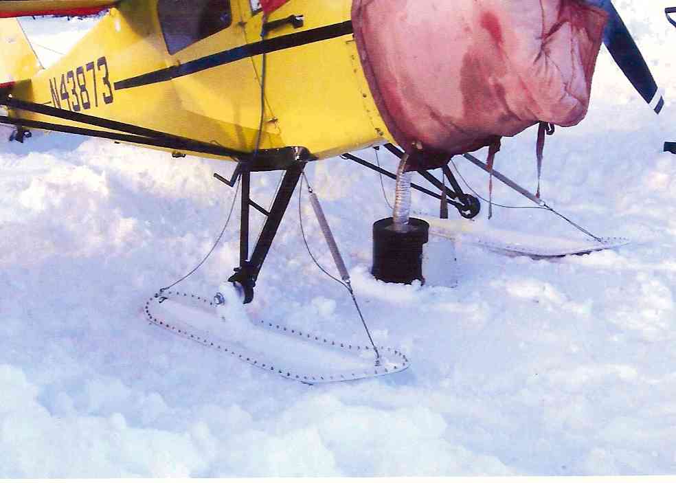

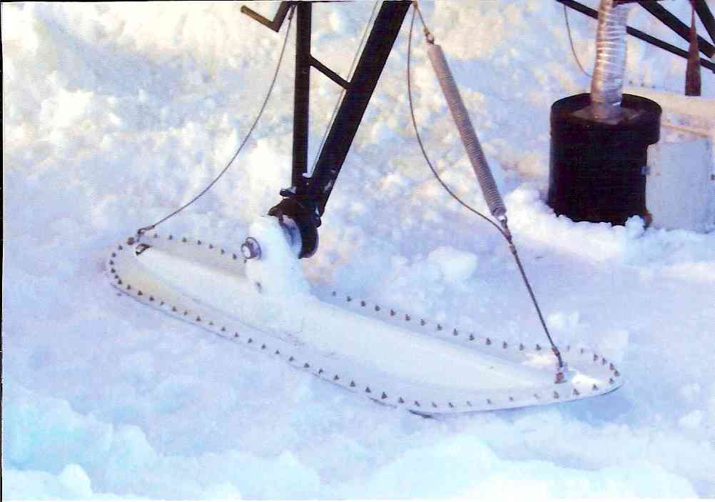

                        I needed a way to preheat without no elect, no baterry and something that would work anywhere in alaska and at any temp. They make alot of new preheating gadgets now but 20 years ago there wasnt much on the market.
                        a 80 year old bush pilot helped me make a pre heater that met all my needs it was siple to make. we used a 5 gallon can made a door for it cut 2 inch holes all the way around the sides near the bottom for the intake cut a hole in the top put on a dryer vent for 4 inch hose and that was it. we used a small coleman stove that burns av gass for heat in the can. It works great ive had the same set up for 20 years had to replace the hose now and then . the holes in the can keep the stove from getting to hot. The door is fairly large so i can put everything inside.pluss while ice fishing or camping in the winter it makes a good heater like a wood stove. Also i put the hose rite under the oil pan it takes about a 45 min at zero deg. at 20 below about 1 and a half hours and your good to go..
                        Lance Wasilla AK

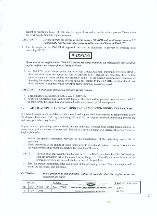

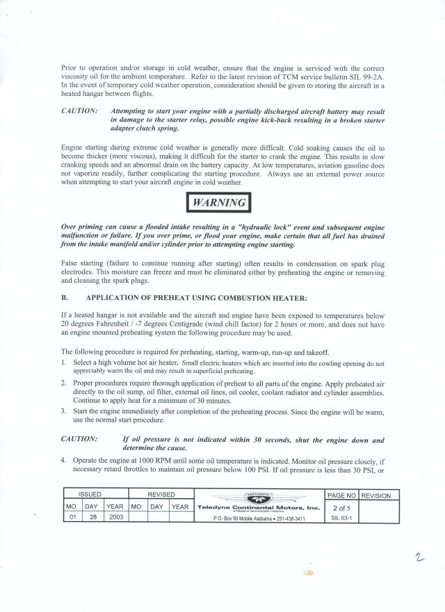

                            I have in my possession, TCM's Service Information Letter (SIL 03-1) which discusses engine preheating. "Preheating is required whenever the engine has been exposed to temps. at or below 20* F or 7*C (wind chill factor) for a period of two hours or more." Pages 2 and 3 discuss use of an external pre-heater which is most of our cases. Please see attached. If anyone wants all 5 pages, gimme your e-mail addy. - Mike
                            Mike Horowitz
                            Falls Church, Va
                            BC-12D, N5188M
                            TF - 14954

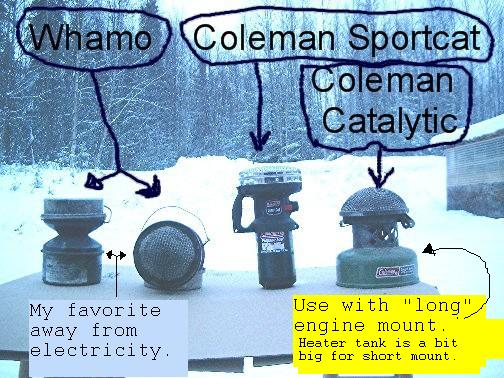

                              Here is a way to heat your plane(with propane) if you can pull your car up close or have a 12 volt battery available. See this link....
                              Here in Alaska we often have to preheat while operating away from regular power, so tend to rely on stand-alone heaters, like a Whamo, Coleman catalytic or Lance's Coleman single burner stove, all of which can operate on Coleman fuel, white gas or any unleaded fuel. I also am planning to try a Coleman Sportcat (small propane cylinder). Have not yet located a Coleman SurvivalCat (see link
                              which is even smaller than my SportCat, but it looks like it would work well, with a good quality, tight-fitting engine cover. Dick
