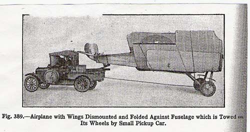

    Not exactly a new idea..but, highway speeds?
      Ha! Let me guess; you've been saving that picture for just this occassion
      Well, Bob said he was going 45 on winding roads.

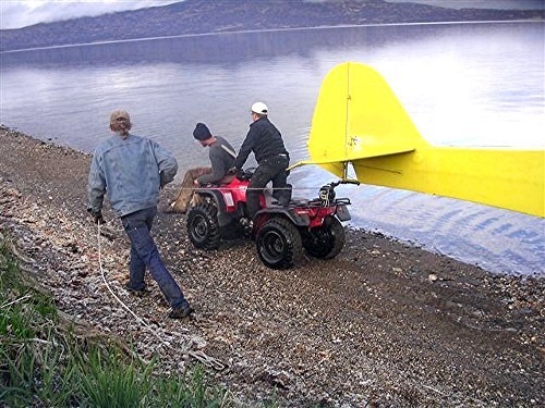

        Re: Beach speed is ok.
        Oh yeah! The lazy man's way to taxi.
              Well, that's OBVIOUSLY Alaska - you know that crew, the'll try anything
