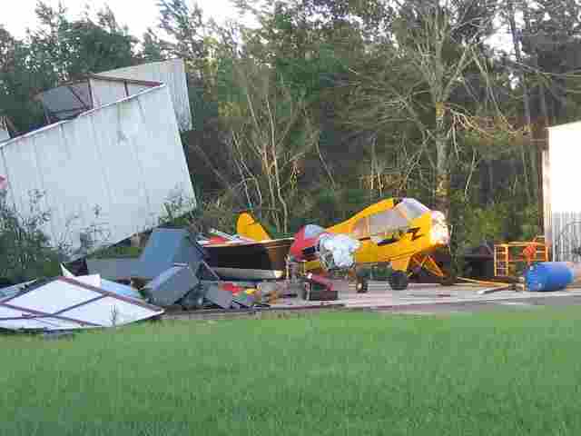

    I promised Crispy Critter I'd post a picture of the hangar that got flipped over at my airport. My hangar and TCraft did fine. But here is the one that didn't. The wings were off of the Cub before the storm. My hangar is just off to the left of the picture. To the right you can see another T-hangar that survived fine. In the background is this T-hangar upside down.
    The small airplane next to the Cub is a Cassutt Racer. You can also see a sailboat that was stored in the hangar.
    The hangar was anchored to the slab, but it's a fairly old hangar and the anchors were quite corroded. It might have held, but it appears that one of the doors failed first and allowed a lot of wind to enter the hangar and blow it up and back.
    I haven't seen the Cub. So I don't know how damaged it is. When I saw the hangar, the airplanes had already been moved.
