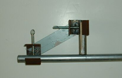

        And here's the jig (page 27) I built from the book - Mike

          I'm not a real expert, but that looks like a pretty good piece of tail to me.
          DC

            Thanks, but although I'm very pleased with what I did, I know the welds could me much prettier, but I know how to improve that. I had a break from everything right after Katrina (I have some property in Biloxi) and my welding seems to have deteriorated. - Mike
