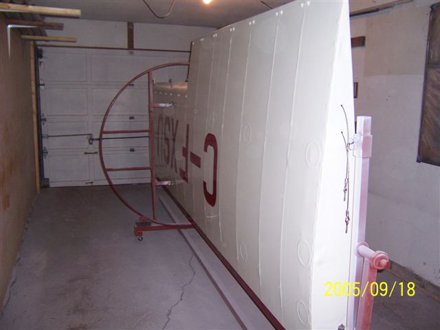

                  I am putting a C-90-12F in my 1951 Model 19 which originally had a C-85-12F. The airplane is being put into the special "Owner Maintenance" category in Canada which allows me to do this engine install with minimal hastle.
                  I just finished my last wing so now the covering and painting is essentially complete with the exception of the two elevators.
