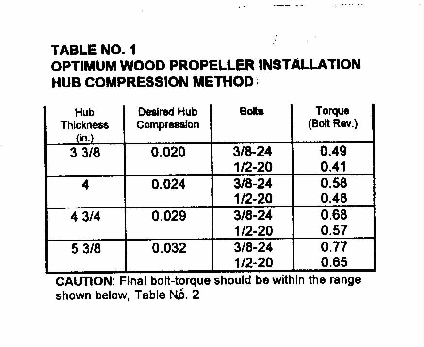

        I looked at the Sensenich site to see if they still have what I call the "deformation table".
        They no longer have it on their site so I scanned it off of the Sensenich 1997 torque instruction sheet for wood props.
        The proper name for it is "Optimum wood propeller installation hub compression method", I like my name for it better.
        It should be attached.
        Dave.

            The table was included in Sensenich's 1997 torques instructions. I have them but only scanned the table. It seems to be the main thing that is different from the new intructions on their site.
            I think 175 -200 ip is probably ok if you have a prop with a 3/8" hole in the back and front. But many of us do not but rather have those big holes.
            But the Sensenich instruction are for a flanged crank. Do you have one? I do not I have a taper shaft and hub. When I say hub I refer to the metal hub.
            I agree, the aluminum bushings work as you say. I was told that by Sensenich too. They are shorter than the hole and do not provide surface area because they are shorther than the hole is deep, they bush the hole to quote you. I tried to get longer ones that did give more area but Sensenich would not go along with that.
            Since the aluminum bushings provide no contact area then if you keep tightening the bolt you will keep pulling the hub "into" the big hole. What I mean by "into" is that the area of the hub at the bolt hole will be out of plane with the rest of the hub, ie. a high spot. That's happening because without a surface on the prop adjacent to the bolt and bolt hole the hub right next to the bolt hole is not being compressed against the wood but is being bent into the big hole. The guys who suggested putting a dowel in th eprop's big hole and then drilling had the best idea,(and I assume one would make the dowel flush with the surface so you get more surface area). Long time ago they made two wood prop configurations, one with big holes for flanged cranks and one with the small holes for taper shafts.

            Bottom line for me is that I don't think torquing the bolts is applicable because the effect of the big hole on the hub has not been considered in the torque value calculation. One would have to model the hub as a circular plate with center load as a first step towards avoiding damage to prop and HUB.
            So my opinion is don't torque but rather use the deformation table instead. It too is not entirely accurate but the method of turning the bolt N revolutions after intial contact has an end. The torque method as I experienced it is nearly endless and the only noticable result was a deformed metal hub.
