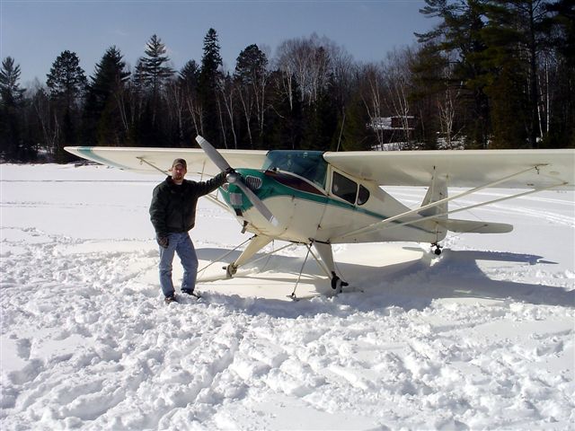

    It's always a good idea to heat up the oil when operating in cold weather. A tank heater would work fine and I think it would save a lot of monkeying around with pre-heating...I do a lot of ski flying and when my plane is parked at my cabin on the lake in the winter I always pre heat the oil and it's kind of a pain. Where is the best place to find an oil heater? and how much do they cost??? With the cost of overhauls these days we gotta do all we can to keep things well lubricated. I always put an aluminum plate on the front of my cowling as shown in the attached picture and I use straight 30 W aeroshell in the winter. I dont have any baffles...but I do have a oil sump cover that snaps over the sump like a jacket...I've only used it twice when it was really cold and I think it helps keep the oil up to temp.

        Dan, How do You attach the metal plate ? bobp
            Sheet metal screws right into the cowling.
