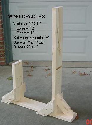

    If anyone has built a wing cradle and has pics, I'd like to see them.
    Also, if there is an alternative way of storing wings, I'd like to see that. - Mike
    It would be for storage or even putting on a flat-bed and moving. - Mike

    Attached is a picture of one of the four wing cradles I built to hold my wings while I worked on my fuselage.
    A piece of carpet was attached from the lower to the upper vertical 2 X 6. The carpet draped so that the bottom of the carpet was about 2" above the base.
