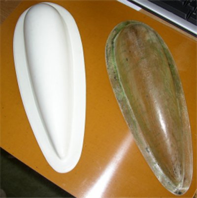

          Here are the bumps - they came in a box of parts with the airplane.
          The white bump looks like it was vacuum formed and the other appears to have been layed up over the first.
          The inner dimension of the bump is 10" long X 2 5/8" wide. The flange is about 3/4".

            Re: REM37BY a Disappointment
            Originally posted by jgerard
            I would love to borrow them Carl. Any luck selling your plane yet?
            Jason
            N43643
            Jason -
            Give me a postal address and I'll get them to you. Or ... I can bring them with me to Columbia.
