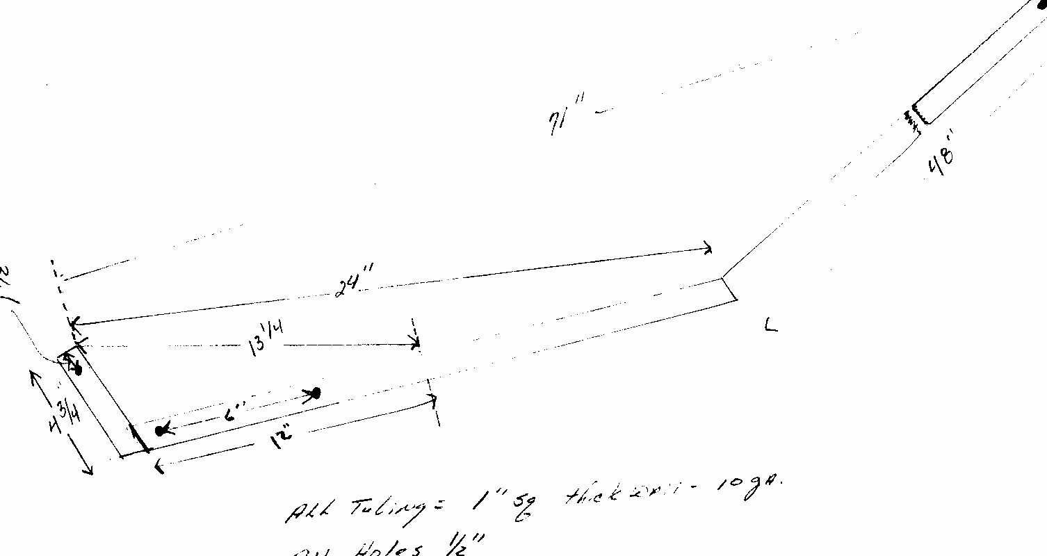

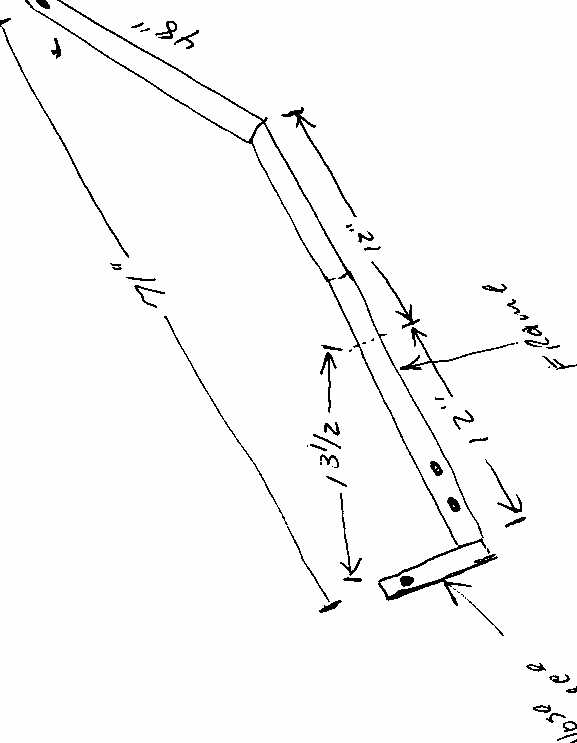

Paul - on the second drawing:
1. Where the 13 1/4" measurement and the 12" measurement meet on the handle, it is unclear what's at that point.
2. The bolts that feed thru the handle and lift the tailwheel are 6" apart and it appears they are both on the handle (as opposed to one being on the handle and the other on the short (4 3/4") piece). When you lift and pull, does the wheel tend to come out of the "bolt cradle" and roll towards the axle? - Mike
Mike Horowitz
Falls Church, Va
BC-12D, N5188M
TF - 14954
The 12"/13.5" measurement is to determine the angle of the 41/2 piece. Measure back from the aft edge of the 4 1/2 in piece a distance of 12". Then,
the distance from the top, aft edge of the 4 1/2 and the distance to the top of the frame will be 13 1/2".
The carriage holes are in the frame/handle. The first one is about 3/4-1" back from the 41/2 nose piece. The distance between the holes is 6" center to center. This seems to work for me and I have the solid Scott tail wheel.
Sorry that my draftmenship is so poor but I made this thing up as I went along. I modified the one that I took the measurements from because I didn't want to infringe on anyone. I am going to try to get a picture and get it posted in a day or two. I think that would help in visualizing this gadget.

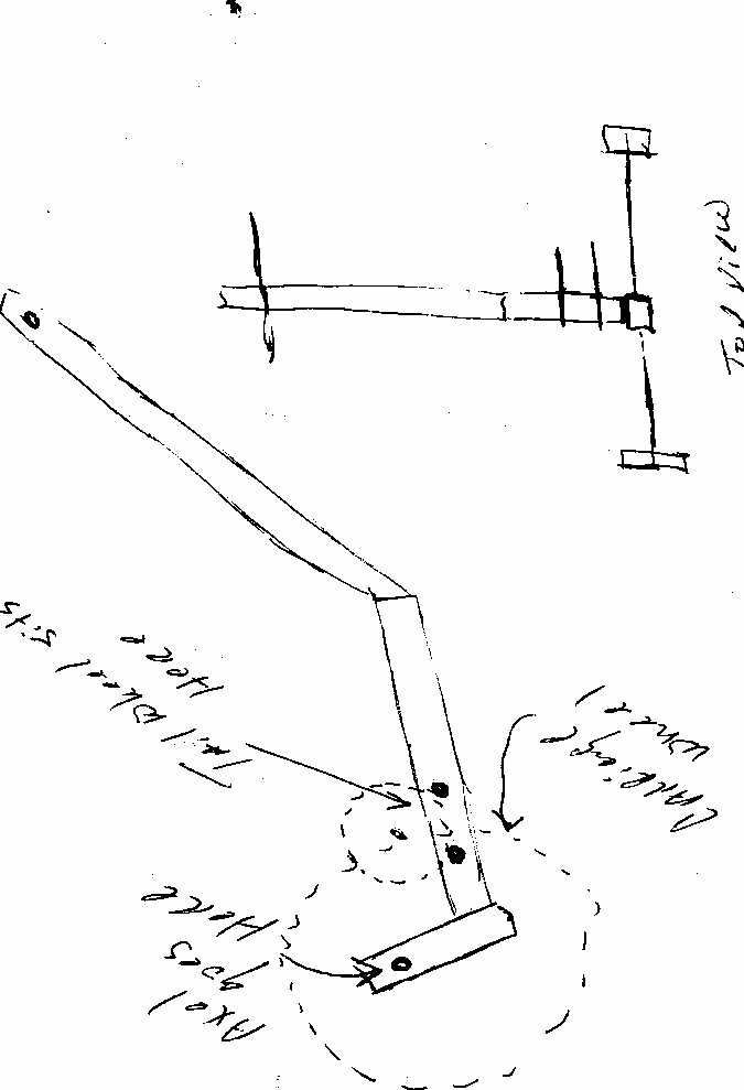

I am attempting to attach another drawing-Hope it works!!!
Sorry, I forgot about your tail wheel question. The tail wheel tends to remain between the the two bolts even over a bump or on fairly rough ground. I can rotate the aircraft 360 deg with little lateral movement of either of the mains.
This thing is absurdly easy to build and doesn't cost much.(Of course, I say that now that I've built one!) It really doesn't take much and makes for an interesting project that is highly useful.
If anyone has any other questions, let me know and I'll do my best to answer same.
