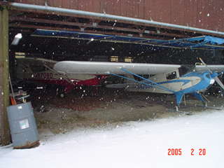

    I see we really have not set up a thread on Ski Planes. There are some references scattered about. This can be used by all with pictures to help the other guys.

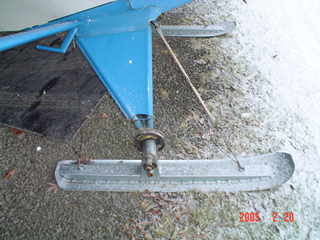

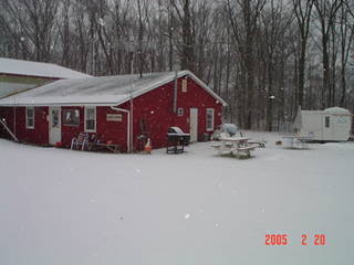

    Here we go, this is my BC12D with my own rigging from AC 43.13-2A , Chapter 5.. These are Federal SC-1's from Feb, 1940 , rated at 1400 lbs. they have stub axles for moving her around ( not shown yet). I attached photos . Note the high tech winter front. I could not find the pretty one, this was made in about 5 mins.. taken Feb 20-05 at 2D1.
    As Mr. Rogers used to say " What a lovely day in the neighborhood"

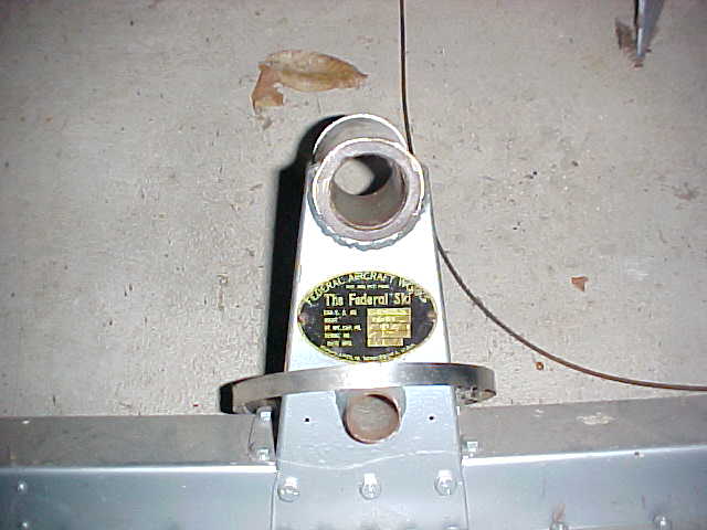

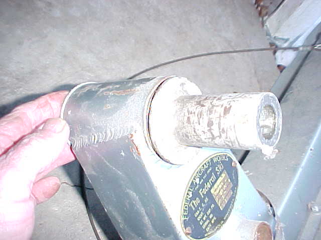

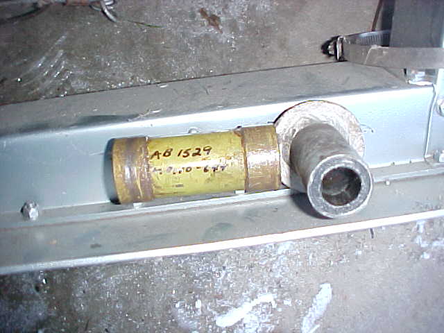

    Then we can back off to December when I installed them. This shows my adapters, etc. must run Kelli-Belle is whining maybe the snow stopped & I can go FLY!

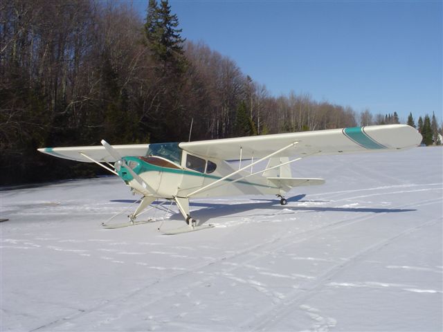

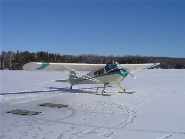

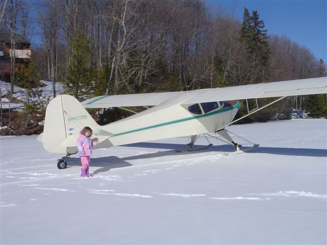

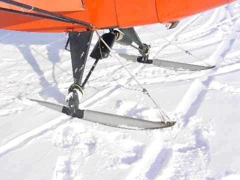

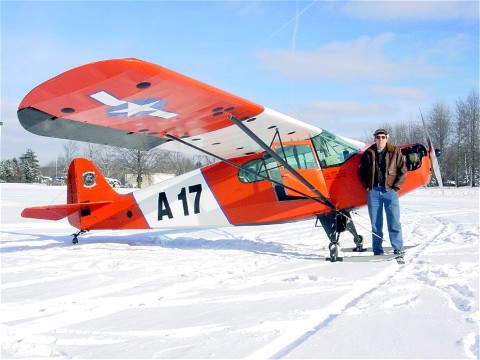

        Here is my DL-65 with Federal 1500's. I plan to put oversized p-tex on them for next season. Been flying out of 6-18" of snow this year.

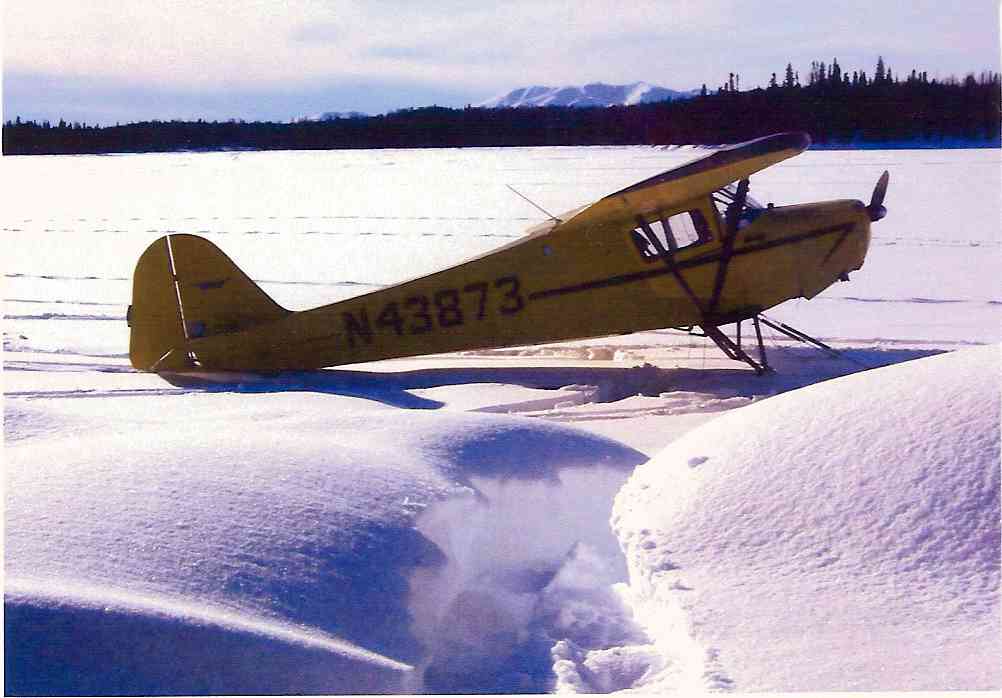

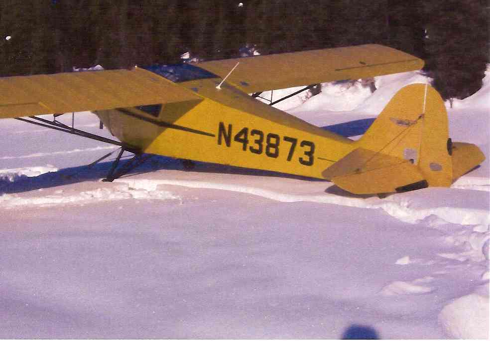

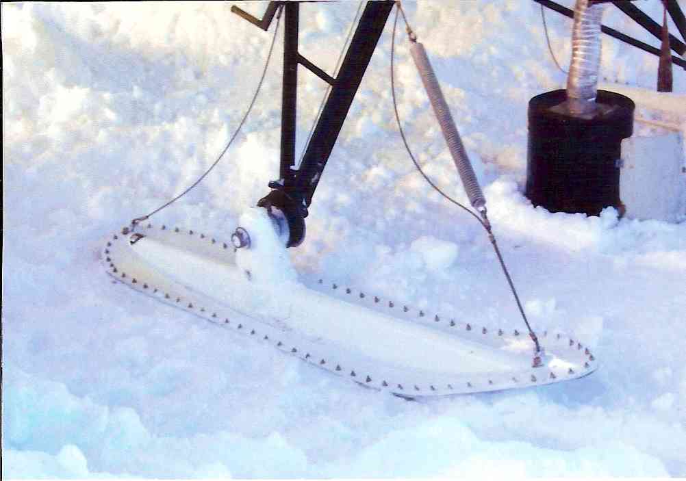

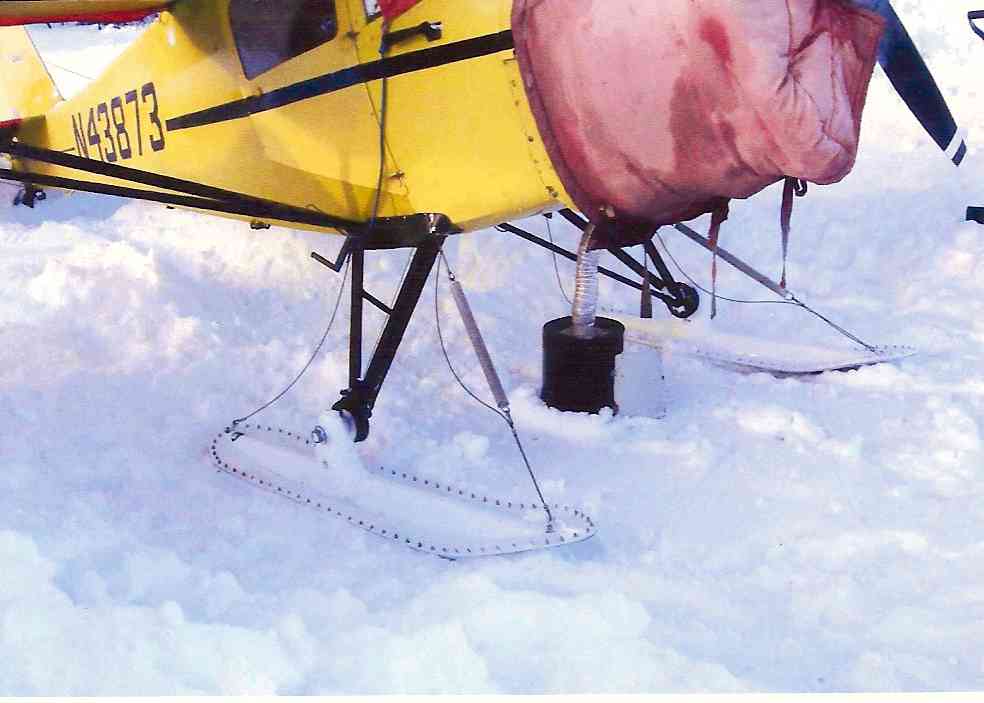

              Played hooky from work today to go ski flying and check out my cabin. Today was a deep snow day landing in 5 ft of layerd snow about 3 feet of semi packed with two feet of soft on top. I have Aero 2000s with ptex on the bottoms, they are a very wide ski comp,to the federal 1500.They also have a curved front that helps you climb up on top of the snow. I use the coil springs that atlee sells they come as a kit. At 20 below shock cord dosnt sretch to good. The screws and nuts on the outer edge holds the ptex on the ski. I have the ski brace thats welded between the gear legs. This brace is a must if you plan to fly in deep snow i personaly know about four t-crafts that have buckeld the gearlegs from turning in snow without the brace. everything is faa approved. I have a scot tail wheel. Today i wish that i had my tail ski on they work real well for deep snow. Snowshoes are a must. i always have them in the plane. I packed down a fifty ft runway in about 20 min.I had a wonderfull day was nice and sunny and 25 deg t shirt and snow pants!!!

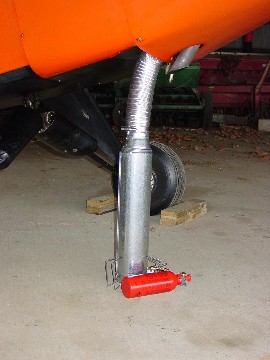

                  Mike, here are some possibilities. These can fit under the cowling, depending on which mount you are using. When away from electric power, I've used the Whamo catalytic the most...(uses Blazo(white gas) I have the short engine mount. Have used the larger Coleman in a C-170. Planning to try the Sportcat(propane). When operating as Lance shows, I've used a single burner Coleman stove. When tied down at home, I use a small electric heater with built-in fan and a commercial thermostatic control. When preheating with anything, I keep away from other people's airplanes and buildings. And I make sure the main fuel tank isn't completely full and the wing tanks aren't draining down into the nosetank. I don't want fuel overflowing into the heat source. Dick

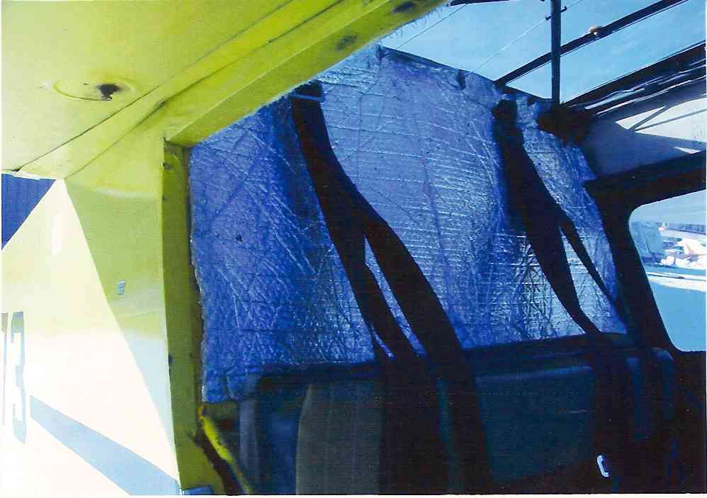

                    Mike the pic of my pre heater is a 5 gallon can with a door and a stack. i have a colman stove that burns av gas that gose inside. What the pic dosnt show for some reason is theres two inch holes all around the lower side of the can the holes keep the stove cooler and they make the draft thrue the stack. When i go out in winter overnight i bring it with me. I like to preheat the inside to i have the propane ctalitic heater sport cat. as the pic shows i made a cover thats gose from the back seat up to the skylight. its made of the silver bubble insulation. It felcros into place. In flight it is twice as warm than without it

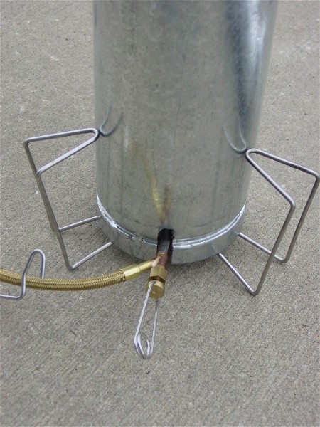

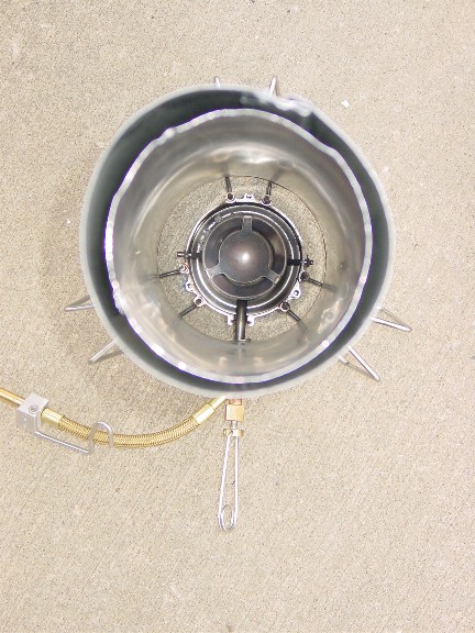

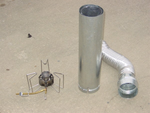

                        I made my preheater out a MSR Dragonfly camping stove. The stove can use multiple fuels (autogas, avgas, white gas, diesel, etc.) I modeled it after the Northern Companion. The stove cost me about $110 and using a double walled stove pipe, reducer and dryer vent, I spent about $30 more. Quick and easy to build. I have preheated with it down to about 0F and it works great.
