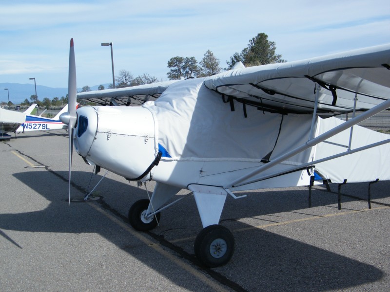

            Here is a shot of the plane with canopy, wing, and fuselage covers.
            Note that both wing and fuselage fuel caps fit properly in the covers. Bruce's did a good job.

                Thanks everyone for the input. I will be ordering some of Bruce's covers soon. I am especially glad to hear that the wing fuel caps fit under their cover. That was a concern until Skip sent his pictures. Thank you! BTW, I relocated my plane from Kelso, Washington KLS to a small airport near Justin, Texas. It took 20.5 hours. I didn't have any problems other than having to wait for fog to lift one morning after stopping in Burlington, Colorado for the night. The last 25 -30 minutes were spent looking for my new home airport. It wasn't in the data base in my GPS and was extremely difficult to find using landmarks. Anyone one reading this in the greater Dallas - Ft Worth area that knows of good places to fly to for hundred dollar hamburgers or a good swimming hole, please send me a PM.

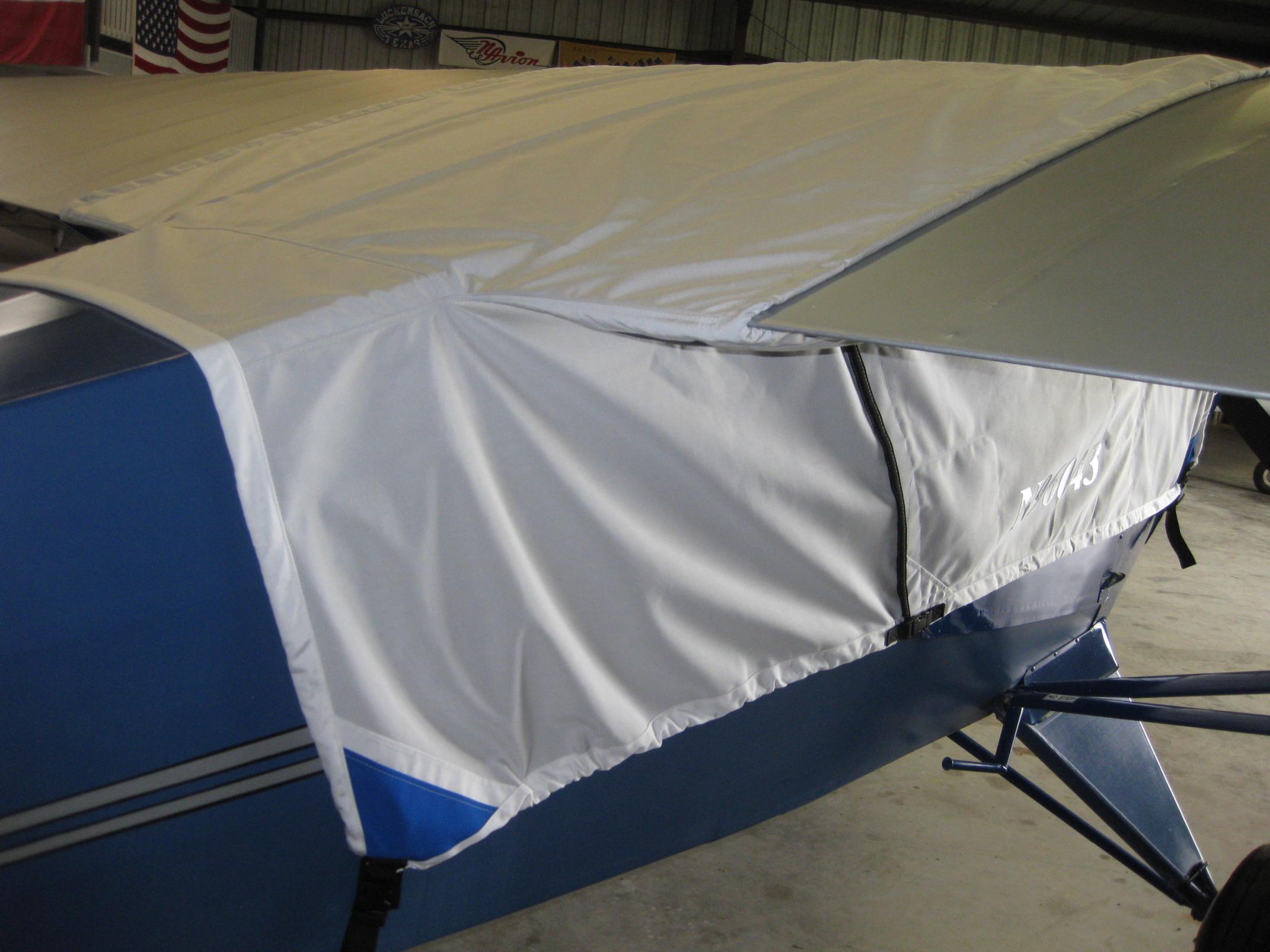

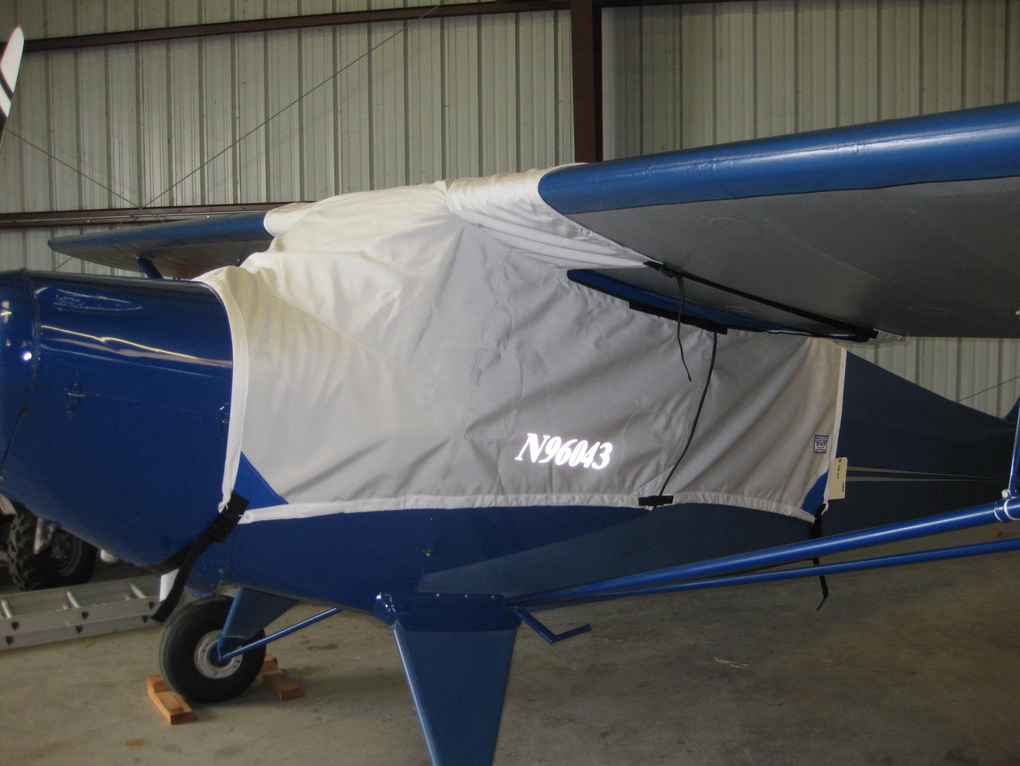

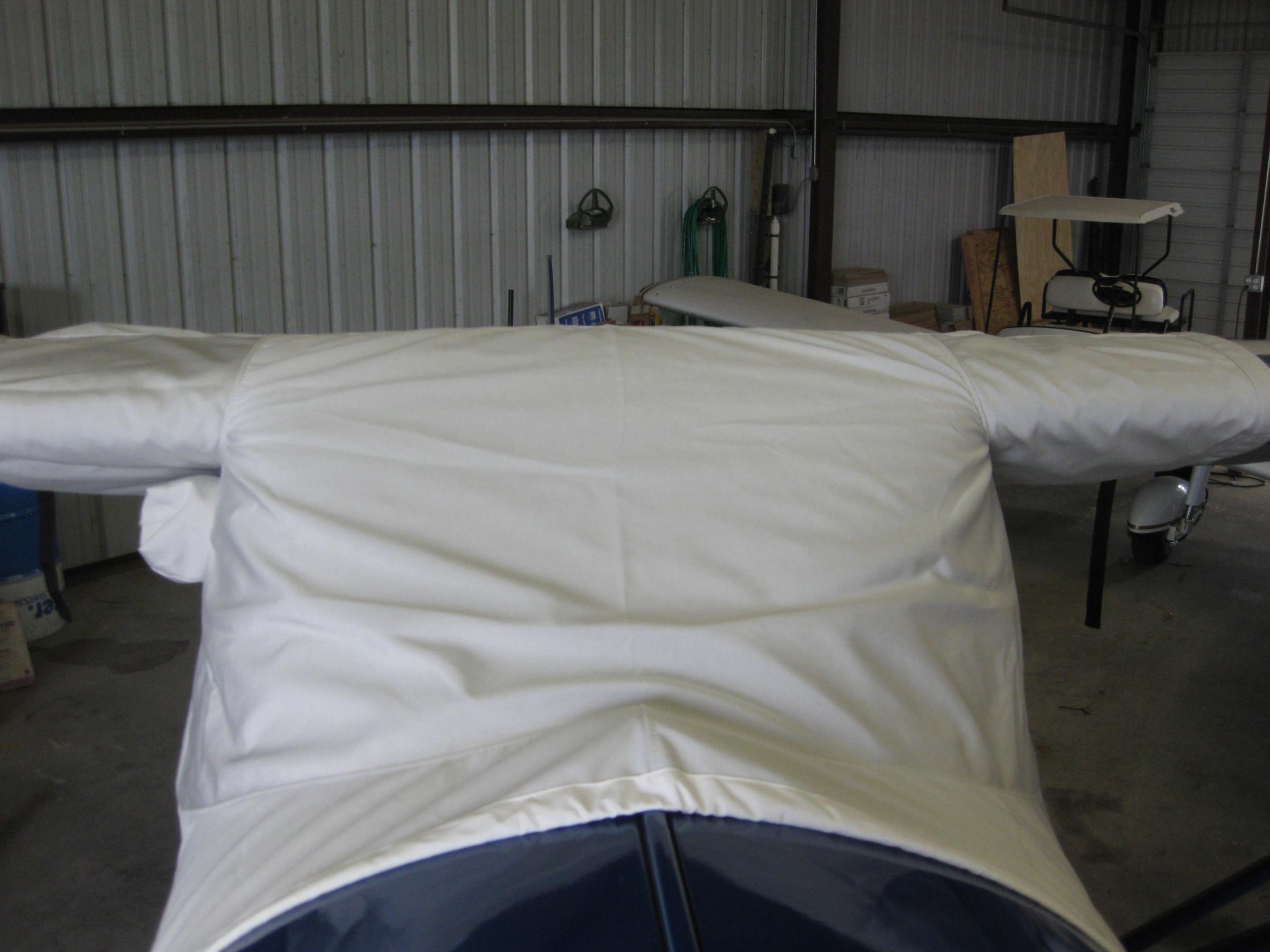

                  I also have used a cover from Bruce's for a few years. I concur with all the comments made so far. It is an excellent product and designed to minimize or eliminate any wear or damage to the airplane. Here are a few photos of my cover in place. If you get down to the Houston area give me a call and/or stop by Sport Flyers (27XS).
