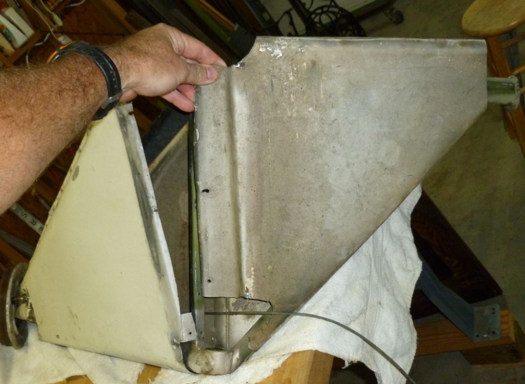

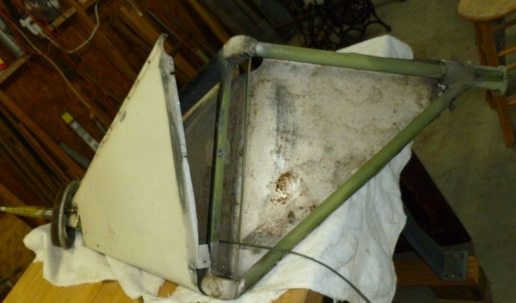

      My '46 BC12-D has aluminum LG covers.
      The covers are attached to the LG channels on my ship.
