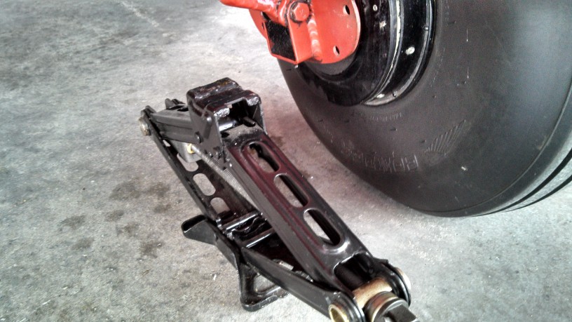

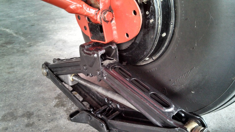

    After re-reading you post, I jack mine up in that small area under the axle. I have a small screw jack, from a Ford Taurus, that catches that area enough to jack it up enough to remove the wheel.
    I will go to the hangar today or tomorrow, I will take a picture and show you.

      Here are the pictures of how I do it.
        Re: How to live with wheel pants?
        Thanks! That is exactly what I wanted to see. Your wheel pant bracket looks stronger that the one I have. Mine is from Wag-Aero. It looks to me like the metal on yours is thicker than mine. It may just be the photo, but I am worried about it being strong enough to hold everything up. Am I seeing an optical illusion, or is your bracket from a different source?
          It was on the plane when I got it. It is fairly stout, though. I can measure the thickness tomorrow.
            The material is 1/8" thick.
