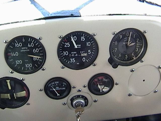

        Day 6 last week of A65-8F break-in on '46 BC12-D with W72CK42 Sensenich wood prop.... calm wind, OAT 65°. IAS confirmed by GPS groundspeed +/- 2 mph.

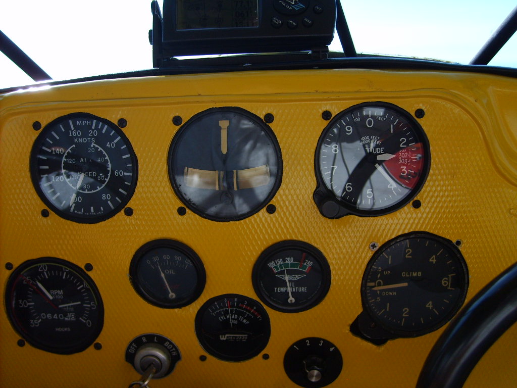

            Yes they will and maybe a little more when my plane was a A65 it would do 100 +/- with mc 74/43 prop now with C85 and and Sensenich 72/40 2550 RPM 110 mph here are a couple photos when it was A65 calm day no wind

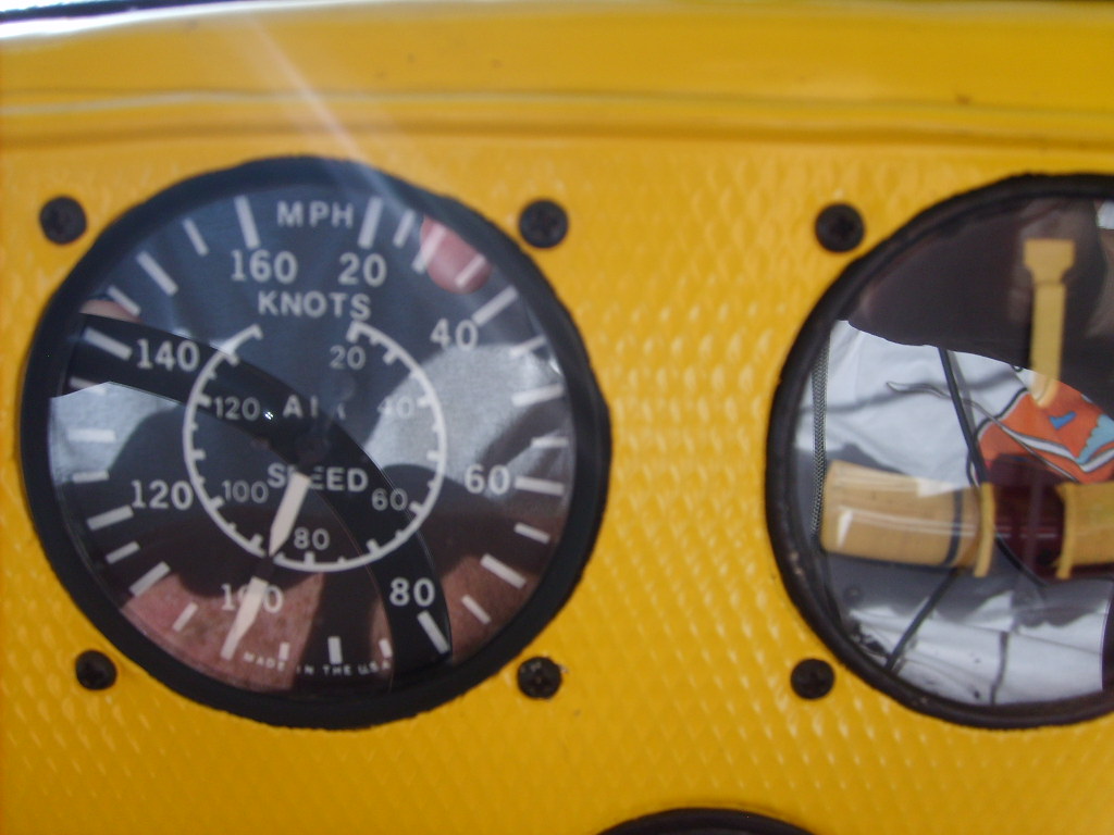

              You are comparing apples and oranges. Also there is some missing information. How an airplane is rigged will make a difference in it's cruise speed, as well as the pitch of the prop. You mention seeing speeds in the upper 80's in videos, but are comparing it with sea level performance figures from the book. I can tell with certainty that my 1946 BC12D, with a 65hp engine and 45 pitch prop, will indicate 95 easily if I am the only one onboard. It does this at only 2000 rpm. If I were to push it up to 2150 rpm, it would easily indicate 102 to 105, depending on the temperature. I can also tell you that it is not rigged 100% perfect.
              There are many variances in tachometers, airspeed indicators, engines, and so on, that have an affect on speed. So it is very possible that the same plane you saw indicate upper 80's in the videos would indicate 95, or even better, at sea level depending on the temperature and how heavy it was. But that doesn't mean it is actually going faster. Upper 80's indicated at altitude will probably be faster than 95 indicated at sea level, depending on the altitude & temperature.
              In the picture below you can see that I am only indicating 75mph. But what may be a little harder to see is that I am at 12,000 feet. My TRUE airspeed was somewhere around 93mph. I hope this helps.
